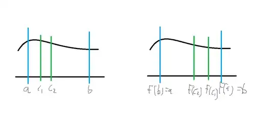

This property is essentially stating that it does not matter whether we integrate from left to right or from right to left.
One way of seeing why this must be the case is considering an interval partition $\mathcal{P}$ of $[a,b]$. For example, let's suppose that the partition contains the intervals separated by the points $a, c_1, ..., c_n, b$.
Then suppose that we apply to this partition the function $f(x) = a + b - x$. The result is another partition $\mathcal{P}'$ separated by the points $f(b), f(c_n), ..., f(c_1), f(a)$ - which corresponds to $a, a+b-c_n, ..., a+b-c_1, b$.
Hence, $\mathcal{P}'$ is another valid partition of $[a,b]$! Therefore the limits of the inferior and superior partition sums induced by both partitions must be equal - ie the equality you wrote.

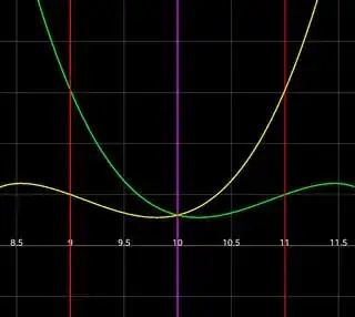

I'm late, other answers have already showed that this particular change of variable works. But, if you really want to see why, I think you could observe that you are integrating over the same interval two functions that are mirrored across the axis through the midpoint of that interval, $x_m=\frac{a+b}{2}$:
In fact, the new function, when evaluated at a certain distance $d$ from the mean of the interval's extremes, has the same value of the original function evaluated at distance $-d$:
$$\bigg[f(a+b-x)\bigg]_{x=\frac{a+b}{2}+d}=f\left(a+b-\frac{a+b}{2}-d\right)=f\left(\frac{a+b}{2}-d\right)=\bigg[f(x)\bigg]_{x=\frac{a+b}{2}-d}$$
lesath82
