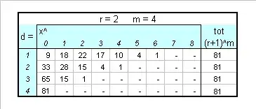

The two formulas above check vs direct computation for low values of the parameters, giving for example
Nb_soglia_2
