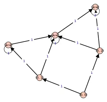

There is a method to count them with a Markov chain where states are $k$-multi-subsets of $[0\dots d]$. I will encode such a multi-subset as a $k$-vector sorted in ascending order. From each state $(x_1, \dots , x_k)$ we make a transition with each value $v \in [1\dots d]$ (having probability $\frac{1}{d}$) to a state that is gotten by
  • If $v<x_1$: replacing $x_1$ with $v$ if $x_1<v$ (and sorting the vector again)
  • otherwise: doing nothing, i.e. transition is to the same state
For example ($k=3, d=6$) from the state $(0, 2, 5)$ with $v=3$ we make a transition to the state $(2, 3, 5)$.
In words, a state records the dice we are currently keeping (zero indicates a missing die) and a transition corresponds to rolling another die.
We start from $(0,\dots, 0)$ and make $n$ transitions, so the probabilities of arriving at a particular state can be read from the first row of the $n$th power of the transition matrix (assuming we index $(0,\dots, 0)$ as the first state). Here's an example with $k=2, d=2, n=3$. In the graph the edge labels mean how many transitions lead to that state, i.e. with how many different die-values is it made. The circles are self-loops. (Sorry, I can't make the picture nice, Sage just draws it how it wants.)
transition graph
If states are indexed as [(0, 0), (0, 1), (0, 2), (1, 1), (1, 2), (2, 2)] the transition matrix is
$$ A = \frac{1}{2} \displaystyle \left(\begin{array}{rrrrrr} 0 & 1 & 1 & 0 & 0 & 0 \\ 0 & 0 & 0 & 1 & 1 & 0 \\ 0 & 0 & 0 & 0 & 1 & 1 \\ 0 & 0 & 0 & 1 & 1 & 0 \\ 0 & 0 & 0 & 0 & 1 & 1 \\ 0 & 0 & 0 & 0 & 0 & 2 \end{array}\right) A^3 = \frac{1}{8} \displaystyle \left(\begin{array}{rrrrrr} 0 & 0 & 0 & 1 & 3 & 4 \\ 0 & 0 & 0 & 1 & 3 & 4 \\ 0 & 0 & 0 & 0 & 1 & 7 \\ 0 & 0 & 0 & 1 & 3 & 4 \\ 0 & 0 & 0 & 0 & 1 & 7 \\ 0 & 0 & 0 & 0 & 0 & 8 \end{array}\right) $$
Now, if we want the probability of the total to equal $s$, sum all the entries of first row off $A^3$ where the state sums to $s$. For the previous example and $s=3$ you would take just the $\frac{3}{8}$ corresponding to the state $(1, 2)$.
Here's a Sage code doing these calculations. The function returns a dictionary that tells for each state how many rolls lead to it, you get probabilities by dividing by $d^n$.
