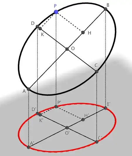

Let $AB$, $CD$ be the principal axes of the ellipse, intersecting at center $O$, and let $P$ be any point on the ellipse, $H$ and $K$ its projections on the axes (see figure below). We have: $$ {OH^2\over OB^2}+{OK^2\over OD^2}=1. $$ Let now $A'$, $B'$, ... be the perpendicular projections of points $A$, $B$, ... on a given plane. As perpendicular projections preserve the ratios of segments on a line, we have: $$ {O'H'^2\over O'B'^2}+{O'K'^2\over O'D'^2}=1. $$ But this equation means that point $P'$ belongs to the ellipse having $A'B'$ and $C'D'$ as conjugate diameters. You can find the principal axes of that ellipse, for instance, following the method explained here.

  • I still don't understand why ${O'H'^2\over O'B'^2}+{O'K'^2\over O'D'^2}=1$ represents an ellipse even if the axis are not perpendicular – Rhino Feb 04 '20 at 20:26
    @Rhino That is the "general" equation of an ellipse, as written by Apollonius of Perga many years ago. Apollonius proved that equation directly from the definition of ellipse as section of a cone. Probably the simplest way to see why it holds is that of regarding an ellipse as a dilation of a circle and conjugate diameters in the ellipse as the transformed of a pair of perpendicular diameters in the circle. – Intelligenti pauca Feb 04 '20 at 20:55
