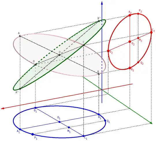

Note first of all that the two projected ellipses are related among them: their points corresponding to the same point of the original ellipse have the same $y$ coordinate. In particular, the two points on the original ellipse having maximum and minimum $y$ coordinate ($C$ and $D$ in figure below) are mapped to the points with maximum and minimum $y$ coordinate on both projections.
Moreover, perpendicular projection preserves parallelism and the midpoint of segments. Hence conjugate diameters and center of the original ellipse are mapped to conjugate diameters and center of the projections. This suggests the following construction.

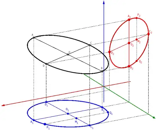

In the $xy$ projected ellipse (blue in figure below) construct diameter $A_1B_1$, perpendicular to $y$ axis and parallel to $x$ axis. In the $yz$ projected ellipse (red in figure below) construct diameter $A_2B_2$, also perpendicular to $y$ axis.
With the help of a chord $P_1Q_1$, parallel to $A_1B_1$, construct then diameter $C_1D_1$ in the blue ellipse, conjugate of $A_1B_1$. Likewise, construct diameter $C_2D_2$ in the red ellipse, conjugate to $A_2B_2$. Note that the tangents at $C_1$, $C_2$, $D_1$, $D_2$ are perpendicular to $y$ axis, hence those points have maximum and minimum $y$ coordinate and correspond to points $C$, $D$ on the original ellipse.
Sending from $C_1$, $D_1$ lines parallel to $z$ axis, and from $C_2$, $D_2$ lines parallel to $x$ axis, we can then construct diameter $CD$ of the original ellipse. Likewise from $A_1B_1$ and $A_2B_2$ we can construct diameter $AB$ of the original ellipse, conjugate to $CD$. In this case we have two possible pairings: either $A_1A_2$ and $B_1B_2$ (as in figure below) or $A_1B_2$ and $B_1A_2$.
In any case, having found two conjugate diameters, the original ellipse is fully determined. Its axes, if needed, can be found with the geometrical construction explained here.
EDIT.
To help visualise the solution, I added another figure with both possible ellipses. Note that they have diameter $CD$ in common.
  • $M_1$ is the center of $P_1Q_1$? The given link to find the axes from the conjugated diameters considers an ellipse in a plane, here we have an ellipse in $\mathbb{R}^3$. – granular_bastard Sep 27 '21 at 23:07
  • @granularbastard Yes, all midpoints of chords parallel to $A_1B_1$ are aligned to form the conjugate diameter. And, by the way, the ellipse IS in a plane and all its geometrical properties hold: you can repeat the construction given there in this case too. – Intelligenti pauca Sep 28 '21 at 07:51
  • $O_1,O_2$ are the projections of $O$ ? – granular_bastard Sep 28 '21 at 11:34
  • @granularbastard Yes, they are. But they are not needed in the construction. – Intelligenti pauca Sep 28 '21 at 11:59
  • @granularbastard I mean: $O_1$ and $O_2$ are the centers of the projected ellipses, hence they are known. From them it is easy to find the center $O$ of the black ellipse, but I didn't use that construction explicitly. – Intelligenti pauca Sep 28 '21 at 13:06
  • @granularbastard Pairing $C_1C_2-D_1D_2$ is forced, because $C$ and $D$ are, respectively, the points on the ellipse with maximum and minimum $y$, and they map to the points, on both projections, with maximum and minimum $y$. You cannot repeat this reasoning for $AB$, where two pairings are possible. – Intelligenti pauca Oct 17 '21 at 06:21
  • @granularbastard I added another figure, to help you see both solutions. – Intelligenti pauca Oct 17 '21 at 15:51
  • @granularbastard That GeoGebra figure is not very useful, as I started from the ellipse in space to construct then its projections. I could make a GeoGebra file with the real construction and share it, if you think it can be useful. But there is no "code" in GeoGebra. – Intelligenti pauca Oct 17 '21 at 17:50
  • Yes you can share. I am missing in the answer a hint why this construction schema works at all. – granular_bastard Oct 17 '21 at 23:43
  • Here's the GeoGebra costruction: https://www.geogebra.org/m/tmjuchh3 – Intelligenti pauca Oct 18 '21 at 07:01
  • @granularbastard I also added some explanation at the beginning of my answer. – Intelligenti pauca Oct 19 '21 at 14:47
  • So C,D are the maxima, minima in y-direction and A,B are on a line perpendicular to y-axis that goes through the origin. Why these 4 points form conjugate diameters and why they are preserved in the projection? – granular_bastard Oct 19 '21 at 21:37
  • If $AB$ is a diameter of an ellipse, its conjugate is the diameter $CD$ such that tangents at $C$ and $D$ are parallel to $AB$. Parallel lines are mapped to parallel lines in the projection, hence the projections of $AB$ and $CD$ are conjugate diameters of the projected ellipse. – Intelligenti pauca Oct 19 '21 at 21:45
  • How do we know that the tangents at the points of maximum and minimum y, i.e. tangents at points C and D, are parallel to line AB? – granular_bastard Oct 19 '21 at 23:37
  • @granularbastard Tangents at $C$ and $D$ lie on planes perpendicular to $y$ axis (otherwise their $y$ coordinate wouldn't be an extremum). And line $AB$ also lies on a plane perpendicular to $y$ axis. Hence... – Intelligenti pauca Oct 20 '21 at 07:23
  • So the problem reduces to projections of bounding parallelograms. In a sketch that contains only parallelograms one would easier see this? – granular_bastard Oct 20 '21 at 12:12
  • @granularbastard What do you mean by "bounding parallelograms", exactly? – Intelligenti pauca Oct 20 '21 at 13:04
  • Each edge of the bounding parallelogram is parallel to one of the conjugate diameters. – granular_bastard Oct 20 '21 at 19:55
  • @granularbastard In that case it is exactly the same thing: the midpoints of the sides of the parallelograms are $ABCD$ and their projections. – Intelligenti pauca Oct 20 '21 at 19:58
