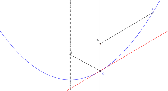

In the case of a parabola, for instance, a diameter is any line parallel to the axis, as $QM$ in figure below. This line, and the line tangent at $Q$ to the parabola, can be taken as oblique coordinate axes: if $R$ is any point on the parabola, $y=RM$ and $x=QM$, then one can show that $$ y^2=px, $$ where line $RM$ is parallel to the tangent and $p=4QF$, point $F$ being the focus of the parabola. This is proven in Apollonius [I.49] (but Apollonius defines $p$ in a different equivalent way).

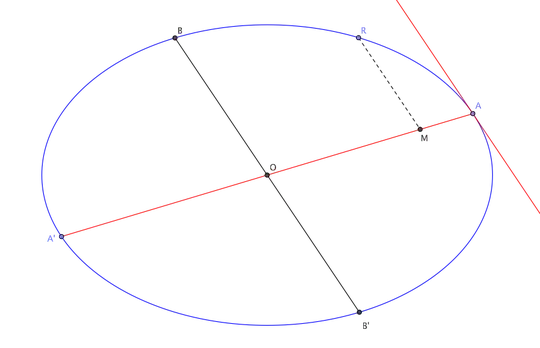

In the case of an ellipse, a diameter $AA'$ (i.e. a chord through the centre of the ellipse, see figure below) and the tangent at $A$ can be taken as oblique coordinate axes: if $R$ is any point on the ellipse, $x=AM$ and $y=RM$, then one can show that $$ y^2=px-{p\over d}x^2, $$ where line $RM$ and diameter $BB'$ are parallel to the tangent, $p=2{OB^2\over OA}$, $d=AA'$. This is proven in Apollonius [I.50], where the analogous statement is also proven for a hyperbola.
