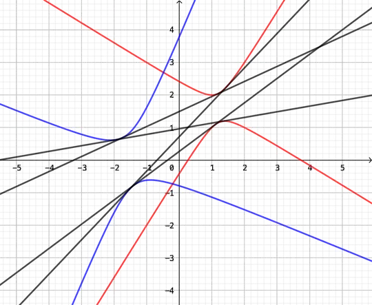

fct
The conics in the image are $$x^2+2xy-y^2+3x+3y+3=0,2x^2+2xy-2y^2-8x+4y+2=0$$

And the common tangent lines are $$\begin{align}0.180395566181265x-1.037735255240134y+1&=0\\0.3091137649277184x-0.6697463463799764y+1&=0\\1.468166586883676x-1.389356814701378y+1&=0\\2.787004998077662x-3.732949087415946y+1&=0\end{align}$$
