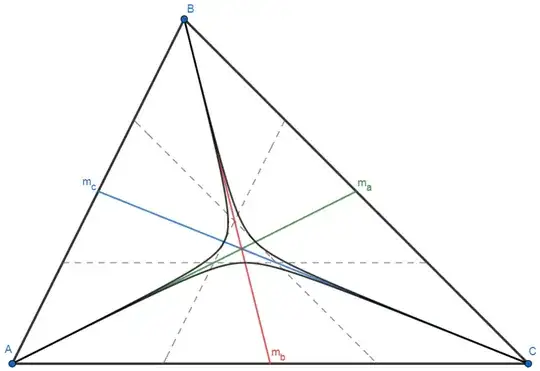

Every tangent to one of the black curves cuts the area of the triangle in half:

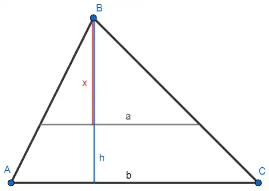

The curves are hyperbolae each determined by two medians which are tangent to them in the vertices of the triangle and another tangent shown in grey which is parallel to one side of the triangle. These are obtained in the following way: $\frac{bh}{2} = ax \quad \frac{a}{x} = \frac{b}{h} \; \to \frac{h^2}{2} = x^2 \quad x = \frac{h}{\sqrt{2}}$ .
For two triangles you have to find the common tangent of the hyperbolae.
