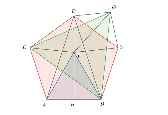

A very nice euclidean approach.
Starting with a regular pentagon $ABCDE$ of side $2$, draw the equilateral triangles $\triangle ABF$ and $\triangle EBG$, as shown below. Produce $DF$ to $H \in AB$.
  1. $\overline{FH} = \sqrt 3$.
  2. $\overline{DH} = \tan 72^\circ$.
  3. $\triangle DGB$ is isosceles, with $\measuredangle DBG = 24^\circ$, hence $\measuredangle BDG = 78^\circ$, and $\measuredangle GDC = 42^\circ$.
  4. Since $\triangle GDC$ is isosceles with base $\overline{CD} = 2$, $\overline{DG} = \sec 42^\circ$.
  5. By SAS criterion $\triangle DAG \cong \triangle ADF$, and, therefore $DF \cong DG$.
  6. By 1., 2., 4., and 5. we have $$\boxed{\tan 72^\circ = \sec 42^\circ + \sqrt 3}.$$
