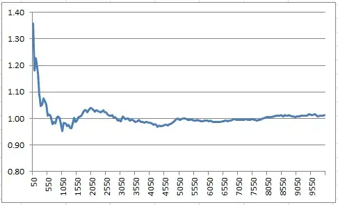

Below is a chart showing convergence to $1$ (relatively slow, of the order $1/\sqrt{n}$ just like for the central limit theorem - not a coincidence - and chaotic) using $y_1=2, z_1=5$. The X-axis represents $n$, the number of iterations. The convergence is much faster when the limit is $3$.

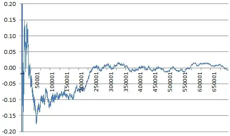

Another interesting chart

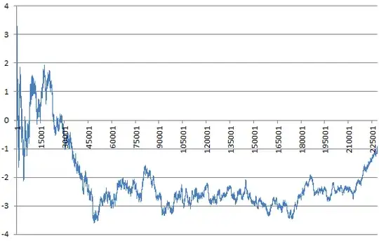

Here I try to build a second order approximation for the limit. Let
$$L(n)= \frac{1}{n}\left(z_{n+1} - \sum_{k=1}^n z_k\right) \tag{$\star$}$$
I am interested in the error $E(n) = \sqrt{n}\cdot \Big(L(n)-1\Big)$. In a traditional problem, you would expect $E(n)$ to tend to a constant as $n \rightarrow\infty$. Not here, the error behaves like a Brownian motion, again, just like in the central limit theorem. Yet the system is fully deterministic here. Note that I used $y(1)=2, z(1)=5$ to produce the chart below.
While I did not test it, I would expect that the same Brownian behavior occurs regardless of the initial conditions, as long as we are dealing with the standard case.
Also, if you look closely at the above chart, I believe it is NOT a true Brownian motion. It is too regular, and most importantly, the error seems to be bounded. The (apparently) bounded error, together with the non-dependence on the initial conditions (yet to be verified) for the probabilistic behavior, makes me think that this problem, after all, might be solvable. And maybe another way to sole this problem is to get good enough asymptotic expansions for $y_n$ and $z_n$.
