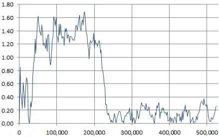

Let $S_n$ denotes the number of binary digits $d_k$ of $x$, that are equal to 1, for $k=1,\cdots, n$. If irrational quadratic numbers were indeed normal as we all believe they are, then, there is an absolute constant $K$ (not depending on $x$), and for each $x$, there is a number $N(x)$ denoted as $N$, such that
$$\mbox{If } n > N, \mbox{ then } S_n - K\sqrt{n} \leq \frac{n}{2} \leq S_n + K\sqrt{n} \tag 3$$
This is a consequence of the Berry-Hessen theorem applied to Bernouilli variables. It is discussed in sections 1.1 and 1.2 in this article. The chart below shows $\frac{|2S_n - n|}{\sqrt{n}}$ on the Y-axis, with $n$ between 0 and 530,000 on the X-axis, for the case $y_0 = z_0 = 1$ leading to $x=\frac{\sqrt{2}}{2}$. It suggests (not a proof) that in this case, $N = 0$ and $K = 0.90$ might work.
To prove that $x$ has 50% of its binary digits equal to 1, a potential approach thus consists in proving that if the previous inequality is true for $n$ large enough, then it is also true for $n+1$, by looking at the worst case scenario for the potential distribution of the first $n$ binary digits of $x$, using the recurrence relation introduced at the beginning, or the backward recurrence.
Some of the numbers $x$ that I tested are approaching the 50% ratio in question rather slowly, for instance if $y_0=1, z_0=16$. Indeed, I am wondering if some of these quadratic irrationals, maybe a finite number of them, even though normal, do not satistfy $(3)$, but instead a weaker result, say with $\sqrt{n}$ replaced by $n^{3/4}$ or $\frac{n}{\log n}$. To the contrary, a very fast convergence, say $n^{1/4}$ or $\log n$ instead of $\sqrt{n}$ in $(3)$, would also mean, even though $x$ may be normal, that its digits are not distributed like i.i.d. Bernouilli$(\frac{1}{2})$ variables. The only way for this Bernouilli behavior to happen, is if the convergence to the 50% ratio occurs at the right speed, that is with $\sqrt{n}$ in inequality $(3)$. In other words, for a specific $x$, any asymptotic departure from $\sqrt{n}$ in $(3)$ would mean that its binary digits are not distributed in a purely random way. This "pure randomness" criterion is stronger than having 50% of the digits equal to 1. For instance, $x=\frac{2}{3}=0.10101010\dots$ (in base 2) has 50% of its digits equal to 1, but the term $O(\sqrt{n})$ in $(3)$ can be replaced by the optimum bound $O(1)$, and the digits look anything but random.
I am doing some simulations and testing at this moment, see for instance my recent question on CrossValidated, here. Another spectacular result that might be more easier to prove is that the correlation between the binary digits of $px$ and $qx$ is equal to $\frac{1}{pq}$ if $p, q$ are odd, co-prime, non-zero integers: see here. A corollary is that if $\alpha,\beta$ are irrationals linearly independent over the set of rational numbers, then their binary digits have zero cross-correlation.
