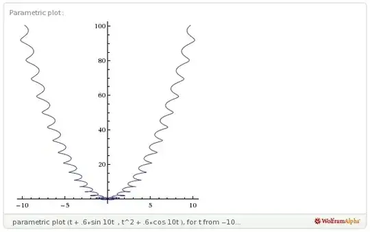

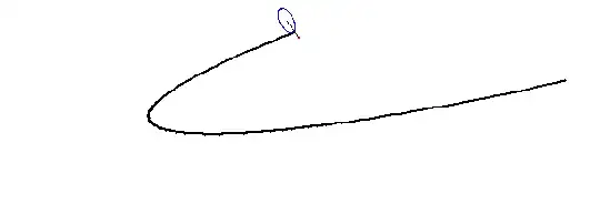

I'm thinking about a circle rolling along a parabola. Would this be a parametric representation?
$(t + A\sin (Bt) , Ct^2 + A\cos (Bt) )$
A gives us the radius of the circle, B changes the frequency of the rotations, C, of course, varies the parabola. Now, if I want the circle to "match up" with the parabola as if they were both made of non-stretchy rope, what should I choose for B?
My first guess is 1. But, the the arc length of a parabola from 0 to 1 is much less than the length from 1 to 2. And, as I examine the graphs, it seems like I might need to vary B in order to get the graph that I want. Take a look:
I played with the constants until it looked ALMOST like what I had in mind.

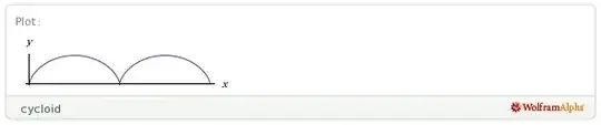

This makes me think that the graph my equation produces will always be wrong no matter what constants I choose. It should look like a cycloid:
Cycloid
But bent to fit on a parabola. [I started this becuase I wanted to know if such a curve could be self-intersecting. (I think yes.) When I was a child my mom asked me to draw what would happen if a circle rolled along the tray of the blackboard with a point on the rim tracing a line ... like most young people, I drew self-intersecting loops and my young mind was amazed to see that they did not intersect!]
So, other than checking to see if this is even going in the right direction, I would like to know if there is a point where the curve shown (or any curve in the family I described) is most like a cycloid--
Thanks.
"It would be really really hard to tell" is a totally acceptable answer, though it's my current answer, and I wonder if the folks here can make it a little better.

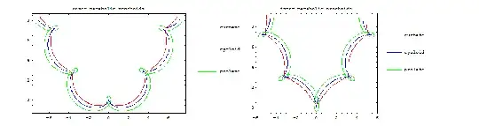

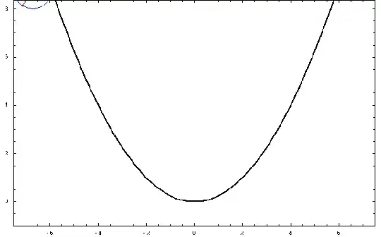

Now, for some plots:
parabolic trochoids
For this picture, I used a focal length $a=1$ and a radius $r=\frac34$ (negative for the "outer" ones and positive for the "inner" ones). The curtate, cycloidal, and prolate cases correspond to $h=\frac12,1,\frac32$.

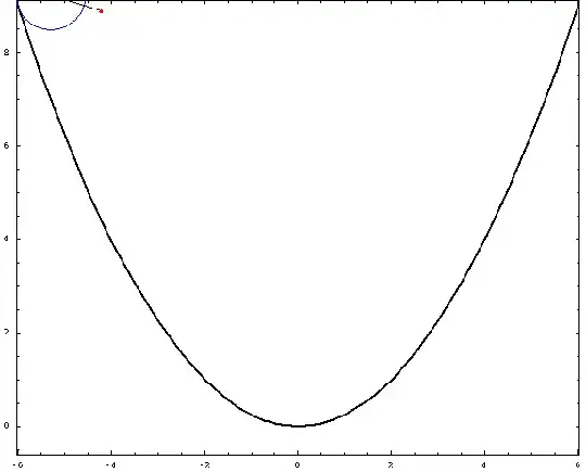

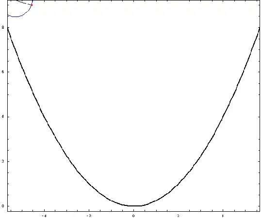

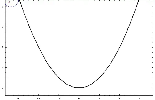

I did promise to include animations and code, so here's a bunch of GIFs I had previously made in Mathematica 5.2:
Inner parabolic cycloid, $a=1,\;r=\frac34\;h=1$
inner parabolic cycloid
Curtate inner parabolic trochoid, $a=1,\;r=\frac34\;h=\frac12$
curtate inner parabolic trochoid
Prolate inner parabolic trochoid, $a=1,\;r=\frac34\;h=\frac32$
prolate inner parabolic trochoid
