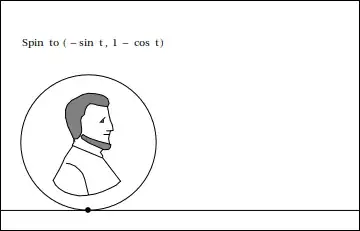

Here is a cartoon depiction of what Robert and Ross were showing, courtesy of Stan Wagon:
rolling penny
The center of the circle moves along a horizontal line at constant velocity. If we want the cusps to be at $y=0$, that means the center should be $(x_c,y_c)=(rt,r)$. Then we add on the location of the point on the rim relative to the center. This will be something like $(r\cos t, r\sin t)$ but we still need to get the phase right. If we start with the point on the rim at $(0,0)$ at $t=0$ the rim point is at an angle of $\frac {-\pi}2$ at $t=0$, that is, pointing straight down. A little fiddling with the phases gets the expression you quote. The scale between the center motion and rotation is set by the requirement that there be no slippage, which means the velocity of the point on the road must be $0$.
