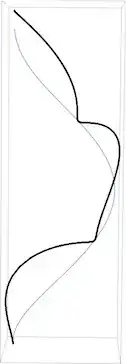

Here's a picture with $a=c=1$ and $r=1/2$:
Helical Cycloid
Note: The above does not simply curl the planar cycloid around the cylinder. Since
$$x^2 + y^2 = a^2 + \frac{4r^2}{b^2} \sin^2\frac{bs}{2r} \cos^2\left(\theta-\frac{bs}{2r}\right) \ge a^2$$
we see that most of the helical cycloid lies outside the surface of the cylinder.
