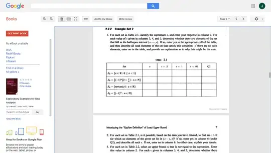

Need help in vetting my answers for Q. 1,2 in section 2.2.2 in chap. 2 (page 7) in CRM series book by MAA: Exploratory Examples for Real Analysis, By Joanne E. Snow, Kirk E. Weller. here.
Q. 1:
For each set in Table 2.1, identify the supremum $s$ and enter your response in column 2. For each value of $\epsilon$ given in columns 3, 4, and 5, determine whether there are elements of the set that fall in the half-open interval $(s - \epsilon, s]$. If so, enter yes in the appropriate cell of the table, and then describe all such elements of the set that satisfy this condition. If there are no such elements, enter no in the table, & provide an explanation as to why this might be the case.
$$\begin{array}{c|c|c|c|c|} Set & \text{$s$} & \text{$\epsilon=.5$} & \text{$\epsilon=.1$} & \text{$\epsilon=.05$} & \text{$Q.\, 2$} \\ \hline \text 1)\,\ S_2 = \{x\in \mathbb{R}: 0\le x \lt 1 \} & 1 & yes & yes & yes &no\\ \hline \text 2)\,\ S_3 = \{(-1)^n(2+\frac 1n)\,: n\in \mathbb{N}\} & 2.5 & yes & yes & yes &no \\ \hline \text 3)\,\ S_4 = \{arctan(x)\,: x\in \mathbb{R}\} & \frac \pi{2} & yes & yes & yes &no\\ \hline \text 4)\,\ S_5 = \{(-1)^n\,: n\in \mathbb{N}\} & 1 & yes & yes & yes &no\\ \hline \end{array}$$
