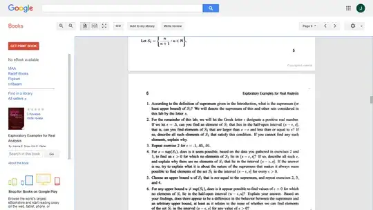

Need help in vetting my answers for Q. 1 in chap. 2 in CRM series book by MAA: Exploratory Examples for Real Analysis, By Joanne E. Snow, Kirk E. Weller. here.
Let $S_1 = \frac n{n+1} : n \in \mathbb{N}$
1. What is the supremum of $S_1$. Denote it by $s$.

4. For $s = \sup(S_1)$, does it seem possible, based on the data you have gathered in exercise $2$ and $3$, to find an $\epsilon\gt 0$ for which no elements of $S_1$ that lie in $(s - \epsilon, s]$? If so, describe all such $\epsilon$, and explain why there are no elements of $S_1$ that lie in the interval $(s - \epsilon, s]$? If the answer is no, try to explain what it is about the nature of the supremum that makes it always seem possible to find elements of the set $S_1$ in the interval $(s- \epsilon, s]$ for every $\epsilon\gt 0$.
Not clear, as for very small $\epsilon$, there should be $n\rightarrow \infty$. But, if consider supremum for such non-attainable values (of $n$ in domain) only then get its value of $s=1$.
So, the exercise must be referring to the ability of supremum as a limiting value, for $n\rightarrow \infty$.
5. Choose an upper bound $u$ of $S_1$ that is not equal to the supremum, & repeat exercises $2,3$, and $4$.
