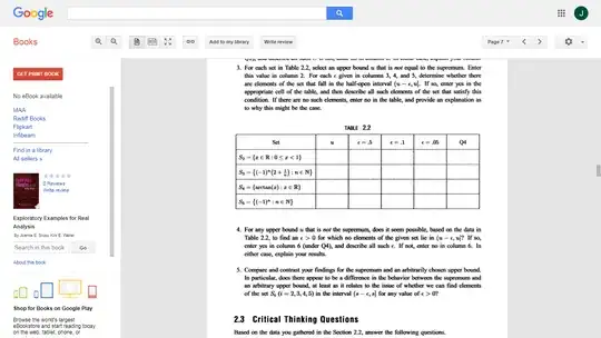

Need help in vetting my answers for Q. 3,4,5 in section 2.2.2 in chap. 2 (page 7) in CRM series book by MAA: Exploratory Examples for Real Analysis, By Joanne E. Snow, Kirk E. Weller. Also, this post is in continuation of my last post's question. here
3. For each set in Table 2.2, select an upper bound $u$ i.e. not equal to the supremum. Enter this value in column 2. For each $\epsilon$ given in columns 3,4, and 5, determine whether there are elements of the set that fall in the half-open interval $(u - \epsilon, u]$. If so, enter 'yes' in the appropriate cell of the table, & then describe all such elements of the set that satisfy this condition. If there are no such elements, enter ''no' in the table, & provide an explanation as to why this might be the case.
$$\begin{array}{c|c|c|c|c|} Set & \text{$u$} & \text{$\epsilon=.5$} & \text{$\epsilon=.1$} & \text{$\epsilon=.05$} & \text{$Q\, 4$} \\ \hline S_2 = \{x\in \mathbb{R}: 0\le x \lt 1 \} & 1.001 & (.501,1] & (0.901,1] & (0.951,1] & Yes \\ & & & & &(\forall u | u-s \ge \epsilon) \\ \hline S_3 = \{(-1)^n(2+\frac 1n)\,: n\in \mathbb{N}\} & 2.51 & \{2.01,\cdots,2.5\} & \{2.5\} & \{2.5\} & --do--\\ \hline S_4 = \{arctan(x)\,: x\in \mathbb{R}\} & \frac \pi{2} + 0.1 & (\frac \pi{2} - 0.4, \frac \pi{2}) & no & no & --do-- \\ \hline S_5 = \{(-1)^n\,: n\in \mathbb{N}\} & 1.2 & \{1\} & no & no & --do-- \\ \hline \end{array}$$

4. For any upper bound $u$ that is not the supremum, does it seem possible, based on the data in Table 2.2, to find an $\epsilon\gt 0$ for which no elements of the given set lie in $(u - \epsilon, u]$? If so, enter yes in column 6 (under $Q 2$) and describe all such $\epsilon$. If not, enter no in column 6. In either case, explain your results.
Yes, if $u-s \ge \epsilon$, then no element of set is in the desired interval, as even the supremum (even, if in range) will be not in the open lower bound.
5. Compare and contrast your findings for the supremum & an arbitrarily chosen upper bound. In particular, does there appear to be a difference in behavior between the supremum and an arbitrary chosen upper bound, as it relates to the issue of whether we can find elements of the set $S_i\,(i=2,3,4,5)$ in the interval $(s - \epsilon, s]$ for any value of $\epsilon \gt 0$?
