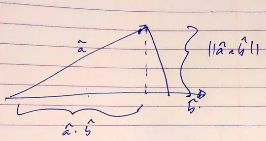

Another way of reconciling the fact that we appear able to add two unlike entities, is to recast the geometric product in polar form. To do so, consider a decomposition of a geometric product in terms of constituent unit vectors $$\mathbf{a} \mathbf{b} = \left\lVert {\mathbf{a}} \right\rVert \left\lVert {\mathbf{b}} \right\rVert \left( { \hat{\mathbf{a}} \cdot \hat{\mathbf{b}} + \hat{\mathbf{a}} \wedge \hat{\mathbf{b}} } \right),$$ and assume that we are interested in the non-trivial case where $ \mathbf{a} $ and $ \mathbf{b} $ are not colinear (where the product reduces to just $ \mathbf{a} \mathbf{b} = \left\lVert {\mathbf{a}} \right\rVert \left\lVert {\mathbf{b}} \right\rVert $). It can be shown that the square of a wedge product is always non-positive, so it is reasonable to define the length of a wedge product like so $$\left\lVert {\hat{\mathbf{a}} \wedge \hat{\mathbf{b}}} \right\rVert = \sqrt{-(\hat{\mathbf{a}} \wedge \hat{\mathbf{b}})^2}.$$
We can use this to massage the dot plus wedge unit vector sum above into $$\mathbf{a} \mathbf{b} = \left\lVert {\mathbf{a}} \right\rVert \left\lVert {\mathbf{b}} \right\rVert \left( { \hat{\mathbf{a}} \cdot \hat{\mathbf{b}} +\frac{\hat{\mathbf{a}} \wedge \hat{\mathbf{b}} }{\left\lVert {\hat{\mathbf{a}} \wedge \hat{\mathbf{b}}} \right\rVert}\left\lVert {\hat{\mathbf{a}} \wedge \hat{\mathbf{b}}} \right\rVert} \right).$$
The sum has two scalar factors of interest, the dot product $ \hat{\mathbf{a}} \cdot \hat{\mathbf{b}} $ and the length of the wedge product $ \left\lVert {\hat{\mathbf{a}} \wedge \hat{\mathbf{b}}} \right\rVert $. Viewed geometrically, these are the respective projections onto two perpendicular axes, as crudely sketched in the figure unit circle dot and wedge product components
That is, we can make the identifications $$\hat{\mathbf{a}} \cdot \hat{\mathbf{b}} = \cos\theta$$ $$\left\lVert { \hat{\mathbf{a}} \wedge \hat{\mathbf{b}} } \right\rVert = \sin\theta.$$
(Aside: Admittedly, I've pulled this sine/wedge identification out of a black hat, but it follows logically from study of projection and rejection in geometric algebra. The black hat magic trick may at least be verified by computing the length of the "rejection" component of the vector $\hat{\mathbf{a}}$, that is, $\hat{\mathbf{a}} - \hat{\mathbf{b}} \left( {\hat{\mathbf{a}} \cdot \hat{\mathbf{b}}} \right)$, which has squared length $ 1 - \left( {\hat{\mathbf{a}} \cdot \hat{\mathbf{b}}} \right)^2$. Expanding $ -\left( { \hat{\mathbf{a}} \wedge \hat{\mathbf{b}} } \right)^2 = -\left( { \hat{\mathbf{a}} \wedge \hat{\mathbf{b}} } \right) \cdot \left( { \hat{\mathbf{a}} \wedge \hat{\mathbf{b}} } \right) = -\hat{\mathbf{a}} \cdot \left( { \hat{\mathbf{b}} \cdot \left( { \hat{\mathbf{a}} \wedge \hat{\mathbf{b}} } \right) } \right) $ produces the same result.)
Inserting the trigonometric identification of these two scalars into the expansion of the geometric product, we now have $$\mathbf{a} \mathbf{b} = \left\lVert {\mathbf{a}} \right\rVert \left\lVert {\mathbf{b}} \right\rVert \left( { \cos\theta +\frac{\hat{\mathbf{a}} \wedge \hat{\mathbf{b}} }{\left\lVert {\hat{\mathbf{a}} \wedge \hat{\mathbf{b}}} \right\rVert}\sin\theta} \right).$$ This has a complex structure that can be called out explicitly by making the identification $$\mathbf{i} \equiv\frac{\hat{\mathbf{a}} \wedge \hat{\mathbf{b}} }{\left\lVert {\hat{\mathbf{a}} \wedge \hat{\mathbf{b}}} \right\rVert},$$ where by our definition of the length of a wedge product $ \mathbf{i}^2 = -1 $. With such an identification, we see that the multivector factor of a geometric product has a complex exponential structure $$\begin{aligned}\mathbf{a} \mathbf{b}= \left\lVert {\mathbf{a}} \right\rVert \left\lVert {\mathbf{b}} \right\rVert \left( { \cos\theta + \mathbf{i} \sin\theta } \right)= \left\lVert {\mathbf{a}} \right\rVert \left\lVert {\mathbf{b}} \right\rVert e^{\mathbf{i} \theta }.\end{aligned}$$
In this view of the geometric product, while we initially added two apparently dissimilar objects, this was really no less foreign than adding real and imaginary portions of a complex number, and we see that the geometric product can be viewed as a scaled rotation operator operating in the plane spanned by the two vectors.

  • Can you clarify how you recognized that the opposite side of the triangle you drew would be: $ \left\lVert {\hat{\mathbf{a}} \wedge \hat{\mathbf{b}}} \right\rVert $? (Unless the hypotenuse was intended to be: $ \left\lVert {\mathbf{a}} \right\rVert \left\lVert {\mathbf{b}} \right\rVert $ ?) It's not obvious to be how the previous equation led to that. – Kevin Goodman Apr 21 '19 at 21:57
  • I didn't show that, but it's not too hard to do. The rejection component of that vector is $\hat{\mathbf{a}} - \hat{\mathbf{b}} \left( {\hat{\mathbf{a}} \cdot \hat{\mathbf{b}}} \right)$ which has squared length $ 1 - \left( {\hat{\mathbf{a}} \cdot \hat{\mathbf{b}}} \right)^2$. If you expand $ -\left( { \hat{\mathbf{a}} \wedge \hat{\mathbf{b}} } \right)^2 $ you'll get the same result. – Peeter Joot Apr 22 '19 at 12:15
  • I've edited the answer to at least describe where this magic trick comes from. – Peeter Joot Apr 22 '19 at 12:26

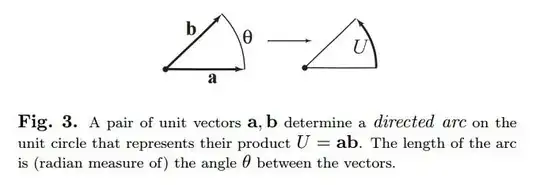

The most intuitive interpretation of a Geometric Product I have found is from Hestenes who notes that it can be visualized as a directed arc just as a vector can be viewed as a directed line.
Geometric Product
For more depth, see page 11 of the following:
Hestenes - Oersted Medal Lecture.

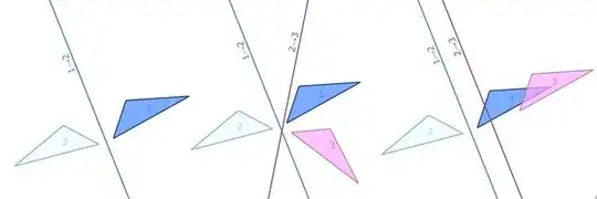

I'll try to explain why there are no apples and oranges, there are only reflections. The apples and oranges appear because in order to actually compute the geometric story I'm about to tell you, we use an orthogonal basis.
Vectors can be thought of as representing (hyper)planes. For example, in 3D space a vector can be used to represent a plane through the origin. Now, a plane $u$ can be reflected in a plane $v$ using
$$ v[u] = -vuv^{-1}, $$
where the minus sign is needed such that when you reflect $v$ in itself, the front and back of the mirror flip ($v[v] = -v$). If we now also perform a reflection in a second plane $w$, we get the rotation
$$ w[v[u]] = (wv)u v^{-1} w^{-1} = (wv) u (wv)^{-1} $$
The composition of two reflections $wv$ is called a bireflection, and could in fact be either a rotation, translation, or a boost. The picture below shows how two intersecting reflections form a rotation, while parallel reflections form a translation.
So the product of two vectors is a bireflection. The apples and oranges only appear because in order to actually compute it, we would have to somehow choose a basis. Staying with the 3D example, we could choose an orthogonal basis $e_1, e_2, e_3$ such that $e_i e_j = \delta_{ij} + e_{ij}$ and represent any plane as $x = \sum_i x^i e_i$.
Now, when we compute the bireflection $wv$ we will get a scalar and bivector part: $$ w v = \sum_{ij}(w^i e_i) (v^j e_j) = \sum_i w^i v^i + \sum_{i \neq j} w^iv^j e_{ij}. $$
So just remember the truth: there are no apples and oranges. For more detail on this approach I would refer to this video, or to the Graded Symmetry Groups paper. Full disclaimer: I'm one of the authors.
