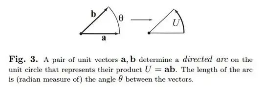

The most intuitive interpretation of a Geometric Product I have found is from Hestenes who notes that it can be visualized as a directed arc just as a vector can be viewed as a directed line.
For more depth, see page 11 of the following:
http://geocalc.clas.asu.edu/pdf/OerstedMedalLecture.pdf
