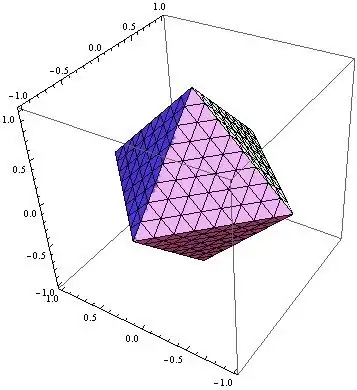

The region $S$ looks somewhat like this:

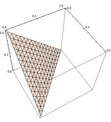

If you consider only the first octant, you have the simplex:
Due to symmetry, the volume of $S$ is $8$ times the volume of this simplex.
That is, $\operatorname{vol}(S)=8\,$$\operatorname{vol}(\{(x,y,z): x,y,z\ge 0, x+y+z\le 1\})$ $=8\times \frac1{6}=\frac 43$.
