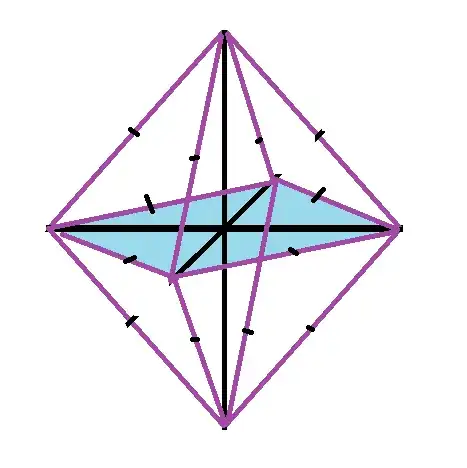

The Volume $V$ is a "Diamond" in 3D , where the Diagonals are the 3 Axis , between $-1$ & $+1$ , in other words , Diagonal length is $2$. Hence Cube Side "Diamond" Side is $\sqrt{2}$.
Image :
DIAMOND
Purple lines are Equal Sides of the "Diamond" , Black lines are Equal Diagonals.
The "Diamond" is made of 2 Pyramids , each with height $2$ & Square Base with Side $\sqrt{2}$.
Blue Area is the Square Base of the Pyramids.
https://www.varsitytutors.com/hotmath/hotmath_help/topics/volume-of-a-pyramid : "volume of a pyramid = one-third the area of the base times the height" : $\sqrt{2}\times\sqrt{2}\times{2}/3=4/3$
Volume Of Our "Diamond" made of 2 Pyramids is $V=2\times(4/3)=8/3$
Hence the Volume $V$ is $8/3$ which is the Integral Domain we want.
