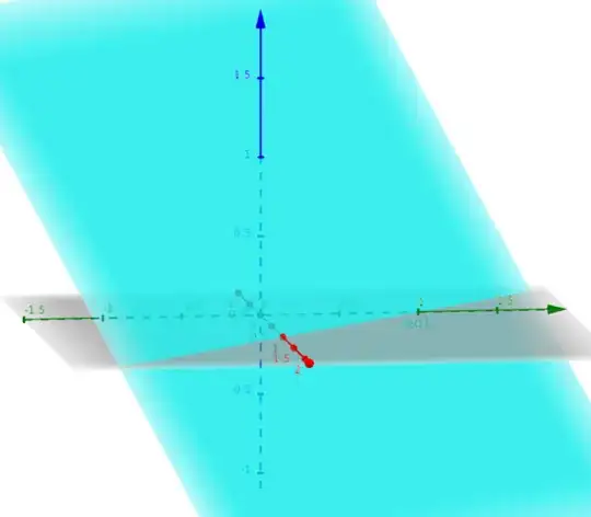

Think of it geometrically, rather than as an integral. As @amsmath mentioned in the comments, it is a super symmetric shape. In fact, it is a regular octahedron centered at origin. We need only find the volume in the first octant. Which is the volume enclosed by the 3 co-ordinate planes and the plane $x+y+z=1$. graph Hence, it's a pyramid with base a right angled triangle of area $1/2$. Hence, it's volume is ${\text{base} \times \text{height} \over 3}={1/2 \times 1 \over 3}=1/6$.
Hence, volume of $M$ is $8 \times 1/6 = 4/3$.
