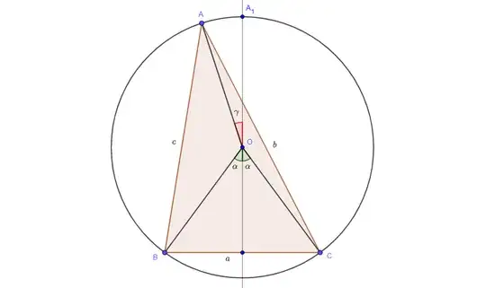

EDIT: I want to present the part of the proof that I don't like. Take an arbitrary triangle $ABC$ with sides $a,b,c$ inscribed in a circle. Consider side $a$ fixed and play with angle $\gamma$ to get different values of $b,c$. I want to prove that isosceles triangle $BCA_1$ has bigger $S$ than any other triangle with one side equal to $a$.
$$b=2R\sin\frac{\pi-\alpha+\gamma}{2}=2R\cos\left(\frac\alpha2-\frac\gamma2\right)$$
$$c=2R\sin\frac{\pi-\alpha-\gamma}{2}=2R\cos\left(\frac\alpha2+\frac\gamma2\right)$$
$$b^2=4R^2\cos^2\left(\frac\alpha2-\frac\gamma2\right)=2R^2(1+\cos(\alpha-\gamma))$$
$$c^2=4R^2\cos^2\left(\frac\alpha2+\frac\gamma2\right)=2R^2(1+\cos(\alpha+\gamma))$$
$$b^2+c^2=4R^2+2R^2(\cos(\alpha-\gamma)+\cos(\alpha+\gamma))=4R^2(1+\cos\alpha\cos\gamma)$$
And this sum achieves maximum obviously for $\gamma=0$, or for $A\equiv A_1$. So for any given side $a$, $b$ and $c$ must be of equal. But you can look at the optimal triangle from sides $b$ and $c$ as well. The only triangle which has no better option is equilateral triangle.
