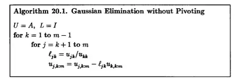

Gaussian Elimination without Pivoting is as follows. The primary purpose of Gaussian elimination if you follow this is to find $\ell_{jk}$ which zeros out the row below. That is why it is the ratio of the two rows and then you subtract them. This continues on and on.
Suppose that
$$ A = \begin{bmatrix} 1 & 1 & 1 \\ 3 & 5 & 6 \\ -2 & 2 & 7 \end{bmatrix} $$ $$ A = LU $$
$$ U =A, L=I$$ $$ k=1,m=3,j=2$$ $$\ell_{21} = \frac{u_{21}}{u_{11}} = \frac{a_{21}}{a_{11}} = 3 $$ $$ u_{2,1:3} = u_{2,1:3} - 3 \cdot u_{1,1:3} $$ Then we're going to subtract 3 times the 1st row from the 2nd row $$ \begin{bmatrix} 3 & 5 & 6 \end{bmatrix} - 3 \cdot \begin{bmatrix} 1 & 1 & 1 \end{bmatrix} = \begin{bmatrix} 0 & 2 & 3\end{bmatrix} $$ Updating each of them $$U = \begin{bmatrix} 1 & 1 & 1 \\ 0 & 2 & 3 \\ -2 & 2 & 7 \end{bmatrix} $$ $$ L =\begin{bmatrix} 1 & 0 & 0 \\ 3 & 1 & 0 \\ 0 & 0 & 1 \end{bmatrix} $$ $$k=1,j=3,m=3 $$ $$\ell_{31} = \frac{u_{31}}{u_{11}} = \frac{-2}{1} = -2 $$ $$ u_{3,1:3} = u_{3,1:3} +2 \cdot u_{1,1:3} $$ Then we add two times the first row to the third row $$ \begin{bmatrix} -2 & 2 & 7 \end{bmatrix} + 2 \cdot \begin{bmatrix} 1 & 1& 1 \end{bmatrix} = \begin{bmatrix}0 & 4 & 9 \end{bmatrix} $$ Updating $$ U = \begin{bmatrix} 1 & 1 & 1 \\ 0 & 2 & 3 \\ 0 & 4 & 9 \end{bmatrix} $$ $$ L =\begin{bmatrix} 1 & 0 & 0 \\ 3 & 1 & 0 \\ -2 & 0 & 1 \end{bmatrix} $$ $$ k=2, j=3,m=3 $$ $$ \ell_{32} = \frac{u_{32}}{u_{22}} = \frac{4}{2} = 2$$ We're subtracting out little blocks $$ u_{3,2:3} = u_{3,2:3} - 2 \cdot u_{2,2:3} $$ $$ \begin{bmatrix} 4 & 9 \end{bmatrix} - 2 \cdot\begin{bmatrix} 2& 3 \end{bmatrix} = \begin{bmatrix} 0 & 3 \end{bmatrix} $$ Updating $$ U = \begin{bmatrix} 1 & 1 & 1 \\ 0 & 2 & 3 \\ 0 & 0 & 3 \end{bmatrix} $$ $$ L =\begin{bmatrix} 1 & 0 & 0 \\ 3 & 1 & 0 \\ -2 & 2 & 1 \end{bmatrix} $$ It now terminates $$ A = LU $$ $$ \underbrace{\begin{bmatrix} 1 & 1 & 1 \\ 3 & 5 & 6 \\ -2 & 2 & 7 \end{bmatrix}}_{A} = \underbrace{\begin{bmatrix} 1 & 0 & 0 \\ 3 & 1 & 0 \\ -2 & 2 & 1 \end{bmatrix}}_{L} \underbrace{\begin{bmatrix} 1 & 1 & 1 \\ 0 & 2 & 3 \\ 0 & 0 & 3 \end{bmatrix}}_{U} $$
