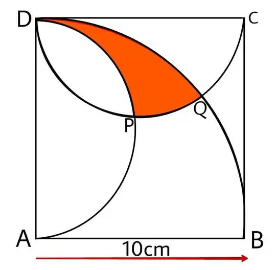

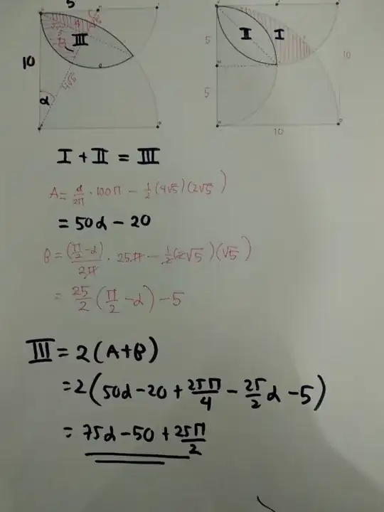

This is a popular problem spreading around. Solve for the shaded reddish/orange area. (more precisely: the area in hex color #FF5600)
find area dpq
$ABCD$ is a square with a side of $10$, $APD$ and $CPD$ are semicircles, and $ADQB$ is a quarter circle. The problem is to find the shaded area $DPQ$.
I was able to solve it with coordinate geometry and calculus, and I verified the exact answer against a numerical calculation on Desmos.
Ultimately the result is 4 terms and not very complicated. So I was wondering: Is there was a way to solve this using trigonometry? Perhaps there is a way to decompose the shapes I am not seeing.
A couple of years ago there was a similar "Find the shaded area" problem for Chinese students. I was able to solve that without calculus, even though it was quite an involved calculation.
Disclosure: I run the YouTube channel MindYourDecisions. I plan to post a video on this topic. I'm okay posting only the calculus solution, but it would be nice to post one using only trigonometry as many have not taken calculus. I will give proper credit to anyone that helps, thanks!
Update: Thanks for everyone's help! I prepared a video for this and presented 3 methods of solving it (the short way like Achille Hui's answer, a slightly longer way like David K and Seyed's answer, and a third way using calculus). I thanked those people in the video on screen, see around 1:30 in this link: https://youtu.be/cPNdvdYn05c.

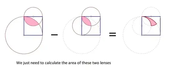

The area is equal to difference between the area of two lenses.
It is easy to find the area of lenses like the one I did in this question before: How to find the shaded area enter image description here

The area can be simplified to $75\tan^{-1}\left(\frac12\right) - 25 \approx 9.773570675060455 $.
It come down to finding the area of lens $DP$ and $DQ$ and take difference.
What you need is the area of the lens formed by intersecting two circles, one centered at $(a,0)$ with radius $a$, another centered on $(0,b)$ with radius $b$. It is given by the expression.
$$\begin{align}\Delta(a,b) \stackrel{def}{=} & \overbrace{a^2\tan^{-1}\left(\frac{b}{a}\right)}^{I} + \overbrace{b^2\tan^{-1}\left(\frac{a}{b}\right)}^{II} - ab\\ = & (a^2-b^2) \tan^{-1}\left(\frac{b}{a}\right) + \frac{\pi}{2} b^2 - ab \end{align} $$
In above expression,
  • $I$ is area of the circular sector span by the lens at $(a,0)$ (as a convex hull).
  • $II$ is area of the circular sector span by the lens at $(0,b)$ (as a convex hull).
  • $ab$ is area of union of these two sectors, a right-angled kite with sides $a$ and $b$.
Apply this to problem at hand, we get
$$\begin{align}\verb/Area/(DPQ) &= \verb/Area/({\rm lens}(DQ)) - \verb/Area/({\rm lens}(DP))\\[5pt] &= \Delta(10,5) - \Delta(5,5)\\ &= \left((10^2-5^2)\tan^{-1}\left(\frac12\right) + 5^2\cdot\frac{\pi}{2} - 5\cdot 10\right) - \left( 5^2\cdot\frac{\pi}{2} - 5^2\right)\\ &= 75\tan^{-1}\left(\frac12\right) - 25 \end{align} $$

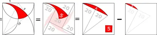

The answer is $5+\frac34 (10^2\arctan(\frac12)-40) = 75\arctan(\frac12)-25 =\pm9.774$.
First I divided the large square in five equal areas of twenty (see image). A part of our shape occupies one fourth of the smaller central square with area 20. The remaining part of our shape consists of half a lense with radius 10 (A), minus a scaled copy of that lense with radius 5 (B). Hence the remaining part of our shape is $\frac34$ of area A.
Area A is obviously a circle segment with area $\frac{2\arctan(\frac12)}{2\pi}\times \pi 10^2 $ minus a triangle of area $40$. $\blacksquare$

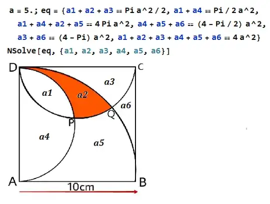

You have six non intersecting subareas, say:
  • S1 is DPD
  • S2 is DQPD
  • S3 is DCQD
  • S4 is CBQC
  • S5 is BAPQD
  • S6 is ADPA
Also say that L is the length of the square.
You can at least state these equations :
  • S1+S2+S3+S4+S5+S6 = $L^2$
  • S1+S6 = $\frac{1}{2}\pi\left(\frac{L}{2}\right)^2$
  • S1+S2+S5+S6 = $\frac{\pi L^2}{4}$
  • S1+S2+S3 = $\frac{1}{2}\pi\left(\frac{L}{2}\right)^2$
  • S3+S4 = $\frac{(2L)^2-\pi L^2}{4}$
  • S2+S5 = $\frac{\pi L^2-\pi\left(\frac{L}{2}\right)^2}{4}$
Alas these are not independent, but I'm pretty sure that you can find six independent ones like this.
  • This approach cannot possibly work unless you find an equation involving $\tan^{-1}(1/2)$. –  Dec 03 '18 at 04:17

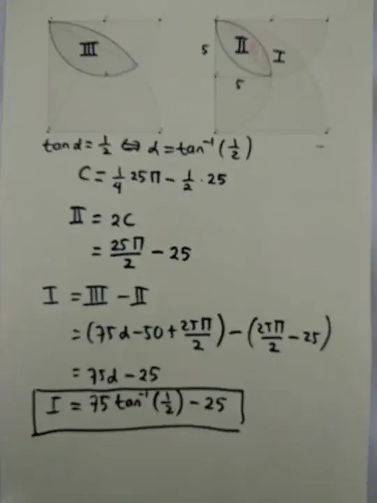

If you add area of blue circle slices and subtract area of green shapes you'll get the area of the shape you want.
schematic
You (trivially) know the area of green shapes.
And you know the size of blue areas because by looking at triangles you can find out that the angles are $2 \ atan \frac{1}{2}$ (larger one) and $\frac { \pi } { 2 } - 2\ atan \frac{1}{2}$ (smaller one).
You just need to divide the angles by $2\pi$ and multiply by area of respective full circles.
The response is:
$$ Area = 100\ (\frac {2\ atan \frac 1 2} { 2 \pi }\pi + \frac { \pi - 2\ atan \frac 1 2} {2\pi} \frac \pi 4 - \pi/16 - 1/4) $$ $$ Area = 100\ (atan \frac 1 2 + \frac { \pi - 2\ atan \frac 1 2} {8} - \pi/16 - 1/4) \approx 9.7735707 $$

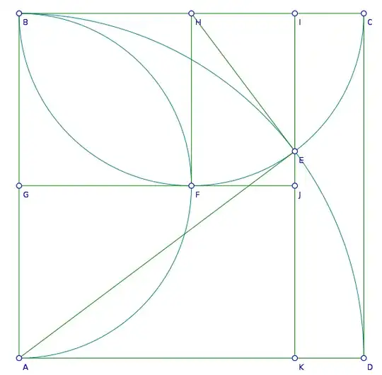

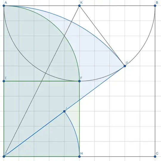

The area can be expressed through rectangles, rectangular triangles and sectors:
$S(BIJG)=S(BIKA)-S(GJKA)$
$S(BEI)=S(BIKA)-S(BEA)-S(AEK)$
$S(HEF)=S(HCF)-S(HCE)=S(BFG)-S(HCE)$
$S(EJF)=S(HIJF)-S(HEF)-S(HIE)=S(HIJF)-S(BFG)+S(HCE)-S(HIE)$
$S(BEF)=S(BIJG)-S(BEI)-S(BFG)-S(EJF)=$ $S(BIKA)-S(GJKA)-S(BIKA)+S(BEA)+S(AEK)-S(BFG)-S(HIJF)+S(BFG)-S(HCE)+S(HIE)=$ $-S(GJKA)+S(BEA)+S(AEK)-S(HIJF)-S(HCE)+S(HIE)$
$HI=x$, $AK=5+x$, $IE=\sqrt{25-x^2}$, $EK=\sqrt{100-(5+x)^2}$, $IK=10=\sqrt{25-x^2}+\sqrt{100-(5+x)^2} \Rightarrow$ $10-\sqrt{25-x^2}=\sqrt{75-10x-x^2} \Rightarrow$ $100-20\sqrt{25-x^2}+25-x^2=75-10x-x^2 \Rightarrow$ $50+10x=20\sqrt{25-x^2} \Rightarrow$ $5+x=2\sqrt{25-x^2} \Rightarrow$ $\sqrt{5+x}=2\sqrt{5-x} \Rightarrow$ $5+x=20-4x \Rightarrow x=3$
$S(GJKA)=5\cdot 8=40$, $S(BEA)=50\cdot \sin^{-1}(AK/AB)=50\cdot\sin^{-1}(0.8)$, $S(AEK)=(8\cdot 6)/2=24$, $S(HIJF)=3\cdot 5=15$, $S(HCE)=25/2\cdot \sin^{-1}(IE/HE)=12.5\cdot\sin^{-1}(0.8)$, $S(HIE)=(3\cdot 4)/2=6$
$S(BEF)=-40+50\cdot\sin^{-1}(0.8)+24-15-12.5\cdot\sin^{-1}(0.8)+6=$ $37.5\cdot\sin^{-1}(0.8)-25$
