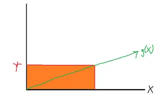

Observe $$F_{\Psi}(\psi) = \mathbb{P}(\Psi \leq \psi) = \mathbb{P}(g(X) \leq \psi)\text{.}$$
Case 1. Suppose $g$ is strictly increasing. Then its inverse $g^{-1}$ is also increasing.
Consider the event $\{g(X) \leq \psi\}$.

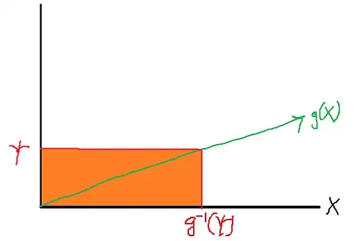

The corresponding values of $X$ such that $g(X) \leq \psi$ are thus those where $X \leq g^{-1}(\psi)$.
Hence,
$$F_{\Psi}(\psi) = \mathbb{P}(g(X) \leq \psi) = \mathbb{P}(X \leq g^{-1}(\psi)) = F_{X}(g^{-1}(\psi))\text{.}$$ and differentiating (don't forget the chain rule), we obtain: $$F_{\Psi}(\psi) = f_{X}(g^{-1}(\psi))\cdot \dfrac{\text{d}}{\text{d}\psi}g^{-1}(\psi)$$ Since $g^{-1}$ is strictly increasing, it follows that $\dfrac{\text{d}}{\text{d}\psi}g^{-1}(\psi) > 0$, so $\dfrac{\text{d}}{\text{d}\psi}g^{-1}(\psi) = \left|\dfrac{\text{d}}{\text{d}\psi}g^{-1}(\psi)\right|$.

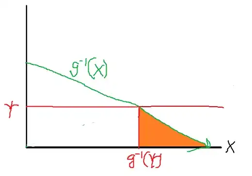

Case 2. Suppose $g$ is strictly decreasing. Then its inverse $g^{-1}$ is also decreasing.
As we can see above, the corresponding values of $X$ such that $g(X) \leq \psi$ are those where $X \geq g^{-1}(\psi)$. Hence,
$$F_{\Psi}(\psi) = \mathbb{P}(X \geq g^{-1}(\psi)) = 1 - F_{X}(g^{-1}(\psi))\text{.}$$ Differentiating and applying the chain rule, we obtain $$f_{\Psi}(\psi) = -f_{X}(g^{-1}(\psi)) \cdot \dfrac{\text{d}}{\text{d}\psi}g^{-1}(\psi)$$ but notice that in this case, $g^{-1}$ is decreasing so $\dfrac{\text{d}}{\text{d}\psi}g^{-1}(\psi) < 0$. Notice the negative coefficient with $f_{\Psi}$. This would this turn $\dfrac{\text{d}}{\text{d}\psi}g^{-1}(\psi)$ into its positive form; hence, we have $$f_{\Psi}(\psi) = f_{X}(g^{-1}(\psi)) \cdot \left|\dfrac{\text{d}}{\text{d}\psi}g^{-1}(\psi)\right|$$ In both cases ($g$ strictly increasing, $g$ strictly decreasing), the above equation is true.
