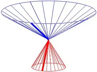

As your question is about visualization, here is a graphical answer:
with orthogonal generating lines (as can be seen on the two thicker generating lines).

Take any one generator of the cone. Draw a tangent plane to that generator. Tangent plane will pass through the vertex. Draw normal to this plane at the vertex. Repeat this for every generator of the cone. You will get a cone. This cone is called reciprocal cone.
