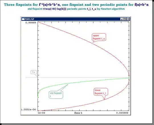

Picture for the three fixpoints for bases $0<b<1/e^e$ (sorry that I used "b" instead of your "a" for the base, it is my long-trained notation)

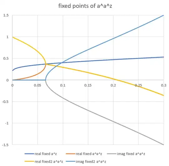

Here is a graph of the fixed points from 0.001 to 0.3. You can compare this graph to Gottfried's graph, where I have added the complex conjugate fixed points for x>exp(-e). The fixed points meet at exp(-e). We see the complex conjugate pair of fixed points to the right, and the real pair of fixed points to the left, as well as the primary real fixed point which is calculated by another method. graph from 0.001 to 0.3
