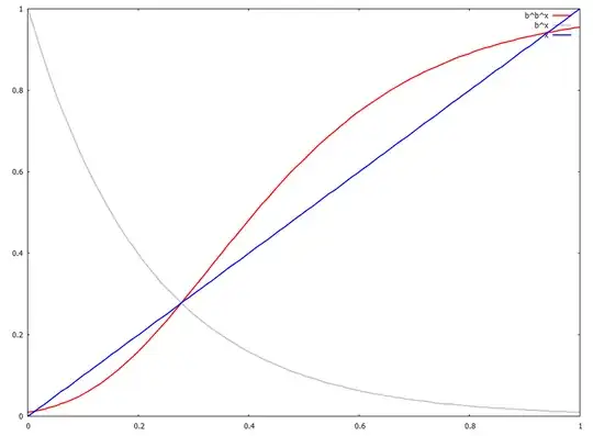

A plot of the function $y_2=b^{b^x}$ using $b=0.01$ (for instance in the picture below) together with $y_0=x$ shows the three fixpoints. Looking at the curve for $y_1=b^x$ as well explains also, why there are three fixpoints.

See this plot: picture The red curve for the function $b^{b^x}$ crosses three times the blue $y=x$ line and by the grey curve for $b^x$ it should be easily recognizable why this must be thus.

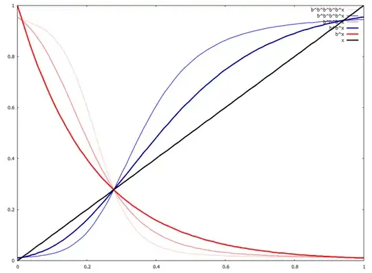

Added: There exists this little bonmot: "If you don't really understand, generalize". Things might even be clearer when more iterations are in the picture.
It suggests that even-height ($h=2k >0$) iterates should have three fixpoints and odd-height ($h=2k+1$) iterates should have one fixpoint.
