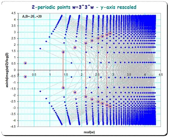

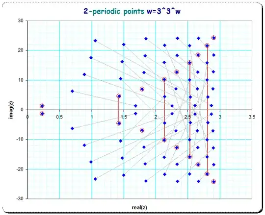

A picture of that $2$-periodic points follows below (this picture shows only that finite subset which are given numerically above plus the $1$-periodic points (fixed points). The set is however infinite).
Most points (blue color) are $2$-periodic, some are $1$-periodic. I've marked the $1$-periodic points (branches are $[A,B]$ with $B=A$) and $2$-periodic points which are pairs of complex conjugate values (branches are $B=-A$) with a red circle and in the second case with red straight lines.
Special cases are that $1$-periodic points with $A=B=0$. Here the initial value (positive or negative imaginary halfplanes) for the Newton-iteration is relevant for finding both fixed points.
For all other $1$-periodic points the given values for all $A=B \ne 0$ make the initial value irrelevant and we get for $A=B=+m$ and $A=B=-m$ the according complex conjugate fixed points.
And more points, making the infinitude of $2$-periodic points more visible. In this picture the $y$-axis is for better impression rescaled by $\sinh^{-1}(\Im(w)/2)/\log(3)$ which is approximate $\log_3(\Im(w))$ but allows zero and negative numbers:

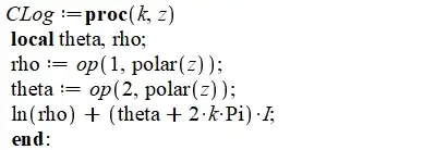

  • I added my Mathematica code above to better show what I'm attempted to use for your method – Dominic Jun 06 '20 at 20:51

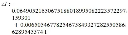

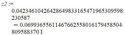

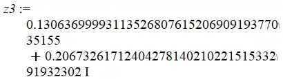

Without wanting to detract too much away from Gottfried's way of solving this, I'd like to point a couple of things that may be of interest to the OP: You can actually solve many transcendental equations, by defining and inverting certain more complex functions (Note that I use a slightly different notation here: solving the equation $c^{c^z}=z$, so your $z$ correponds to my given $c$) Similar to how $z=c^z$ is solved by Lambert's $W$ function which inverts the map $zc^{-z}$, when solving the equation $zc^{-z}=1$ as $z_k=\frac{W_k(-\log(c))}{-\log(c)}$. For example, you can define the map $HW$ to be the inverse of $z\exp(\log(c)\exp(\log(c)z))$, which can solve then the equation $c^{c^z}=z$ or $f_c^{(2)}(z)=z$, where the $(2)$ denotes two-fold composition of $f_c(z)$. Such inverse maps always exist, by virtue of Lagrange's Inversion Theorem, so they can calculate solutions to similar equations fast.
For example, for a given $c\in\mathbb{C}$, then a solution of $c^{c^z}=z$ will be given as:
$$z_0=\frac{HW(-\log(c);\log(c))}{-\log(c)}$$

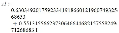

Using the Maple code from the back of this article, for specific $c=-2-i$ this is calculated with at least 8 digits of accuracy as: $z_0\sim 0.243918+0.1945752i$. $z_0$ along with $f_c(z_0)$ will be a 2-cycle. Check: $f_c(z_0)=1.8014674-0.9762585679$, and $f_c^{(2)}(z_0)=z_0$.
In one of the later articles it is proved that such maps ($HW$) are actually multi-valued as well and are given a recursive procedure to calculate the other branches $HW_k$, $k\in\mathbb{Z}$, without resorting to numerical methods, except to improve accuracy. So, speaking generally this seems to confirm Gottfried's result that the solutions are at least countable for each $c\in\mathbb{C}$.

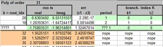

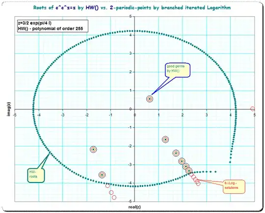

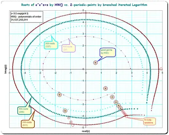

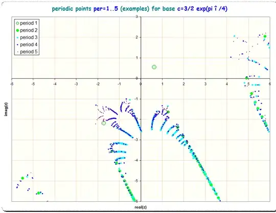

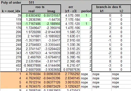

I am updating this to note an interesting connection: When I compare Gottfried's picture for 2-periodic points below in Update #5 with the actual image of the Julia Set for $g_c(z)=c^z$, for $c=3/2\exp(\pi i/4)$, the periodic points appear to be suspiciously close to the periodic fixed points on the outside layer of the Julia Set. I include a pic here for the Julia Set for this $c$, so you can discern yourself:
It appears that there are many many more, as Gottfried's correspond only to the outer recursive layer of the Cantor Bouquet. The main greenish circular feature is the fixed point of convergence of the iterated sequence $g_c^{(\omicron p)}(z)$. All greenish circular features in the Cantor Bouquet are also fixed points, but repelers. If you unwind the Bouquet down to smaller copies of itself, the pattern repeats around the sub-bouqets. This appears to suggest that there is a continuum of such points, or, all the fixed points are indexed by $\mathbb{Z}^{\infty}$.
I also checked the algorithm of my $HW$ functions, but unfortunately I cannot make it work to pick up more solutions. The problem seems to be related to the fact that the roots of the poly are far away from Gottfried's 2-periodic solutions and the algorithm picks up a wrong root - which then feeds to Newton and produces an overflow. I will try to optimize it a bit and see if I can make it work to pick up at least the roots that Gottfried has listed in Update#5.

Dominic, sorry, I was a bit hasty on my last comment. You can use the code in the second article to list all solutions. Make sure you note the difference between the two codes. The second article initializes as "fun:=1;" instead of "fun:=exp(x);" With that change, here's how you do it:
First, you need to define your exponential in terms of the log you use. The complex log map is multivalued, so accordingly you have to use the following to define all possible branches of the exponential. First, the multibranch Log:
Now, you can define $k$ equations to be solved, as follows. First the exponential:
Then the equation:
Then solve as:
For $k=0$ this returns the 1-period value:
enter image description here, which is already checked.
Now continue by excluding this root:
And now resolve again, by:
This returns the second solution:
However, if you now continue by excluding this root, we get an overflow, which means there are no other roots for the principal branch:
This returns: enter image description here
which is rejected by overflow.

Now exclude this root, as before and resolve:
I get:
Check that it is a solution:
evalf(abs(fck(1, c, fck(1, c, z2))-z2));
                                                -22
    7.970129586530190428460234100205063324531 10
Repeat as per the article. I get:
Check for $z_3$:
evalf(abs(fck(1, c, fck(1, c, z3))-z3));
                                                -22
    6.120230393085432839683304733125906593712 10
and you can continue this way, until there's overflow. When you get an overflow, move to a different branch, like $k=-1$ or $k=2$, etc. You get the idea. You can thus list the solutions for all branches of the Complex Log. Again, to stress the important point here: the exponential $c^{c^z}$ will attain different values depending which branch of Log you use. What you really have is $k$ different equations for $k\in\mathbb{Z}$.

update 6: new picture overlaid n-periodic points for p=1..5

Update to table 2: increasing the order of the $HW()$-polynomial to 255 I get the additional 3 roots which approximate the according further $2$-periodic points (by comparing with the Newton-iteration on the branched iterated logarithm):
newtonLb([ 4,0],base)  \\  2.141681046 - 3.108582204*I   2-periodic
newtonLb([ 5,0],base)  \\  2.270468331 - 3.335544479*I   2-periodic
newtonLb([-1,0],base)  \\ -1.353190085 - 3.554170025*I   2-periodic
Here is a picture showing the incidence of the roots of the order-$255$-polynomial of the $HW()$ and the 2-periodic-points as been found by the branched iterated logarithms. $8$ $HW()$-roots coincide usefully with the b.i.log. - solutions. Don't know what to say about the other roots... :
And to see the effect of increasing the polynomial order in the $HW()$ - function for its power to approximate the 1- and 2-periodic points, I show an overlay of plots for roots of polynomial orders 31,127,255,511 with the $K=[k_1,0]$ indexed periodic points. The $HW()$ can only detect as many periodic points as lay in the interior of the hullcurve of its set of roots (with decreasing approximation towards the hullcurve).
The newly detected 2-periodic-points are as follows (values polished by Newton-iteration):

(update 5) To shed some light on the quality of the roots as indicators of the period-points I show a short table with the 14 usable roots $z_1=root[k]$ and the difference to $z_3=base^{base^{z_1}}$
To compare with the 31-order polynomial we find 2 roots as usable indicators nearby two periodic points. The third I've marked with question-marks: this root is not inside the circular-curve, gives a significant error by iteration and comparision $|z_1-z_3|$ and should possibly not been accepted as an initial value for a follow-up Newton-iteration. picture

Update 6: To illustrate more that the branched iterated logarithm-mechanism agrees better with the image of the Julia-set when we do not look at 2-periodic points alone, I've added a picture which includes all n-periodic points for n=1..5 which I've found by simply scanning the complex square at origin from $4+4î ... -4-4î$ in steps of $1/20$ and applying the Newton algorithms for periodic points from periods of 1 to 5 separately.
Of course this documents not all existing periodic points there, only which I found by that specific screening. Moreover, to have a smoother visual impression, I reduced the list of points to that which are in the complex square at origin from $6+6î ... -6-6î$.
All so found periodic points agreed with the branched iterated logarithm scheme, where however for at most 2 exemplars in each n-periodic list there was no uniqueness (meaning: two different cycles with the same vector of branch-indices $K$). For that type of special cases I've not yet an explanation or formalization.

  • @Dominic - The proximity of the roots to the true 1- and 2- periodic points is very well for the innermost points and degradates for the 2-periodic points near the circular bound. With the 511-order polynomial the best proximity of the root and the respective periodic-point was 1e-311 (innermost), and the worst about 0.03 (near circular "curve"). With the 31-order polynomial the three valid proximities were between 1e-11 (inner most) to 0.3 or so (near the boundary curve). (This was always computed with 400 dec digits precision for sw-arithmetic) – Gottfried Helms Jun 11 '20 at 14:45
  • If needed I can provide my data as Pari/GP or the data for pictures as excel-file, btw... – Gottfried Helms Jun 11 '20 at 14:47
  • @Dominic - I've inserted a screenshot of the relevant part of my Excel-file for the "good" roots of the 511-order polynomial for $HW()$. The first two roots might be taken as given, but all other roots I'd polish with Newton-iteration towards best approximation to the periodic points. – Gottfried Helms Jun 11 '20 at 15:14

  • There is a $2$-periodic fixpoint not too far away, $$ p_1=1.28384 - 1.64735 î \phantom{=p_1}\ p_2=5.78514 + 2.04891 î \phantom{=p_1}\ p_3=1.28384 - 1.64735 î =p_1$$. However, this is one with my indexing p_1=newtonEb([1,0],base) and I did not yet understand, how the $HW()$ would find it (didn't see the slot for the branch specific parametrization)?(ah, just observed @Yiannis' 2nd comment when composed my) – Gottfried Helms Jun 09 '20 at 18:26
  • I believe there are ZxZ enumerated 2-cycle points for all z except at the singular points. – Dominic Jun 09 '20 at 18:26

  • @Yiannis: I am actually very familiar with that diagram you speak of: It is a cycle diagram for a tetration iteration z^z^(...) and shows only the regions were that iteration, after a finite number of iterations converges to cycles of various lengths, or diverges. However, it is not a diagram of the solutions of z^(z^w)=w. – Dominic Jun 09 '20 at 19:08
  • @Dominic: yes, of course. But note that the solutions you speak of, naturally depend on $c$ (your $z$). If you pick a $c$ and the iteration $f_c(z)$ goes into a $p$-cycle for $p>2$, you can't get 2-period solutions for your equation. That's obvious. If you get such a solution, it means your $c$ you picked forces a $p=2$ cycle and that's impossible. So the period of the iteration DEPENDS on $c$, not the other way around. You CANNOT get solutions of different period than what the iteration for $f_c(z)$ and thus $c$ specifies. That would be impossible. –  Jun 09 '20 at 19:30

This is not a real answer, just another protocol as mentioned in my comment at Dominic's answer.
The list of roots of the order-31 polynomial taken from the truncated taylorseries for $f(w)=w \lambda \cdot z^{-z^w}$ where $\lambda:=\log(z)$ to solve for $f(w)=\lambda$.
In the rows the iterations according to $z=3/2 \cdot \exp(\pi î /4)$ up to $3$'th iteration is shown to make visible the solutions with periodicity.
The two roots, which are also periodic points are over-/underlined

One sees in row 17 the (approximation to) 2-periodic point, which I'd found in my earlier comment (with vector of branchindexes $K=[1,0]$ in my notation-style) and in row 25 the 1-periodic point which was already computed by Dominic ($K=[0,0]$ in my notation).

  63   0.630349201759+0.551315566237*I   =z1         1-periodic point
       0.630349201759+0.551315566237*I   =z2=c^z1~z1
       0.630349201759+0.551315566237*I   =z3=c^z2~z1
       0.630349201759+0.551315566237*I   =z4=c^z3~z1

  • Gottfried, what do you make of the other roots (all rows except 17 and 25)? They do not appear to be 2 or 1 cycles, so what do you do with them? Do you reject them in your root-finding algorithm? Thanks. –  Jun 10 '20 at 17:50
  • @Yiannis - I'm not sure. At the moment I assume, that they are leagal roots of the polynomial; so if we insert them in the polynomial-formula instead of the intended exponential-iteration, they'll show that they are roots. But polynomial/truncated Taylorseries is not equal to the original Taylorseries of our target-function $ z a \exp(-a \exp(a z) = a$, so they are roots more or less "far" away from the solutions of the target function - and so we can throw them away. (...) – Gottfried Helms Jun 10 '20 at 18:21
  • (...) In the set of 127 polynomial roots only 5 had an error $abs(z_1-z_3)$ less than 1 - and that were good germs for finding the target-function roots using Newton-iteration starting from them. The errors of the other polynomial roots were $3 .. x e125$ and more. For the 255-order polynomial only $8$ have been good germs for the Newton-iteration, and 247 were unusable so far. Could not yet make any more sense of it myself... – Gottfried Helms Jun 10 '20 at 18:25
  • @Yiannis - please see the picture in my updated other answer. It shows the coincidence of the 2-periodic points and the roots of the $HW()$-function with 255-order polynomial. $8$ roots are well approximations of the 2-periodic points with $K=[A,0]$ with $A=-1 .. 5$. – Gottfried Helms Jun 10 '20 at 19:36
  • Gottfried, so in summary, how many valid solutions does your method return for the principal branch of log? I mean without using $2k\pi i$ in your branched log iteration. Can you list them so I can check them by hand? I am a little curious. Thanks. –  Jun 10 '20 at 20:23

  • I just noted this, and it may be interesting to how it applies for your algorithm. Note that all fixed points $-W_k(-\log(c))/\log(c)$ of period 1 are solutions to the equation $c^{c^z}=z$, so $\mathbb{Z}$ is indexed once already in the solutions. Can you produce a similar (to your answer in protocol 2) graph ONLY for fixed points of period 2 with your method? It'd be interesting to see how many roots are indexed this way, separately. Thanks. –  Jun 11 '20 at 10:38
  • @Yiannis - perhaps the newly appended table in my current answer, (update 5) is informative enough for your question. If not, just ping me, but it might be possible I'll be active on this in the evening only. – Gottfried Helms Jun 11 '20 at 15:23
