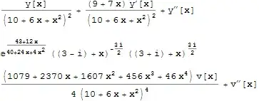

Unfortunately this is not an answer to your question but I have found another broad class of ODEs, similar to those above, which are solved in terms of the doubly-confluent Heun functions. They are: \begin{equation} \left(p_2+q_2 x+r_2 x^2\right)^2 y^{''}(x) + \left(p_1 + q_1 x\right) y^{'}(x) + p_0 y(x)=0 \end{equation} where both $p_2\neq 0$ and $q_1 \neq 0$ and $p_0 \neq 0$. By eliminating the coefficient at the 1st derivative, i.e. by writing: \begin{equation} y(x)=\exp\left(-\frac{1}{2} \int \frac{\left(p_1 + q_1 x\right)}{\left(p_2+q_2 x+r_2 x^2\right)^2} dx \right) \cdot v(x) \end{equation}
they are always reduced to the following ODE: \begin{eqnarray} v^{''}(x) + \frac{{\mathfrak P}_0+{\mathfrak P}_1 x + {\mathfrak P_2} x^2 + {\mathfrak P_3} x^3 + {\mathfrak P_4} x^4}{(p_1 x+q_1)^4 (p_2 x+q_2)^4} \cdot v(x)=0 \end{eqnarray} which in turn can be always solved in terms of the doubly confluent Heun functions as demonstrated in Algorithm for solving a large class of linear 2nd order ODEs with polynomial coefficients. .
See the following Mathematica code snippet for the illustration of that:
{p0, q0, r0} = RandomInteger[{1, 10}, 3];
{p1, q1, r1} = RandomInteger[{1, 10}, 3];
{p2, q2, r2} = RandomInteger[{1, 10}, 3];
Clear[y]; x =.; Clear[v];
myeqn = (p2 + q2 x + r2 x^2)^2 y''[x] + (p1 + q1 x) y'[x] + (p0) y[x];
myeqn = Collect[
  myeqn/Coefficient[myeqn, y''[x]], {y[x], y'[x], y''[x]}, Simplify]
mycoeff = Coefficient[myeqn, y'[x]];
myparam = Coefficient[PowerExpand[Sqrt[Denominator[mycoeff]]], x^2]^2;
m[x_] = Simplify[
  Exp[Total[(-1/2) Integrate[
      List @@ Apart[
        Numerator[
          mycoeff]/(myparam Times @@ (x - # & /@ (x /.
                Solve[Denominator[mycoeff] == 0, x]))), x], x]]]]
y[x_] = m[x] v[x];
Collect[Simplify[myeqn/m[x]], {v[x], v''[x]}, Simplify]
