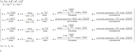

Below I enclose the implementation of this algorithm in Mathematica:
e =.; g =.; d =.; a =.; q =.; A =.; B =.; CC =.; DD =.; x =.;
{P0, P1, P2, P3, P4} = RandomInteger[{1, 10}, 5];
{p1, p2, q1, q2} = RandomInteger[{1, 10}, 4];
myinput = (P0 + P1 x + P2 x^2 + P3 x^3 +
    P4 x^4)/((p1 x + q1)^4 (p2 x + q2)^4)
{A, B, CC, DD} = {p1, q1, p2, q2};
num = -(B CC - A DD)^2 {-4 a B^3 DD - 4 B d DD^3 + d^2 DD^4 +
     B^4 e^2 + (-2 B^2 DD^2 + 2 B d DD^3) g + B^2 DD^2 g^2 +
     e (2 B^2 d DD^2 + 2 B^3 DD g) + 4 B^2 DD^2 q,
    4 CC d^2 DD^3 - 4 d DD^2 (3 B CC + A DD) -
     4 a B^2 (B CC + 3 A DD) +
     4 A B^3 e^2 + (-4 B DD (B CC + A DD) +
        2 d DD^2 (3 B CC + A DD)) g + 2 B DD (B CC + A DD) g^2 +
     e (4 B d DD (B CC + A DD) + 2 B^2 (B CC + 3 A DD) g) +
     8 B DD (B CC + A DD) q,
    6 CC^2 d^2 DD^2 - 12 a A B (B CC + A DD) -
     12 CC d DD (B CC + A DD) +
     6 A^2 B^2 e^2 + (6 CC d DD (B CC + A DD) -
        2 (B^2 CC^2 + 4 A B CC DD + A^2 DD^2)) g + (B^2 CC^2 +
        4 A B CC DD + A^2 DD^2) g^2 +
     e (2 d (B^2 CC^2 + 4 A B CC DD + A^2 DD^2) +
        6 A B (B CC + A DD) g) +
     4 (B^2 CC^2 + 4 A B CC DD + A^2 DD^2) q,
    4 CC^3 d^2 DD - 4 a A^2 (3 B CC + A DD) -
     4 CC^2 d (B CC + 3 A DD) +
     4 A^3 B e^2 + (-4 A CC (B CC + A DD) +
        2 CC^2 d (B CC + 3 A DD)) g + 2 A CC (B CC + A DD) g^2 +
     e (4 A CC d (B CC + A DD) + 2 A^2 (3 B CC + A DD) g) +
     8 A CC (B CC + A DD) q, -4 a A^3 CC - 4 A CC^3 d + CC^4 d^2 +
     A^4 e^2 + (-2 A^2 CC^2 + 2 A CC^3 d) g + A^2 CC^2 g^2 +
     e (2 A^2 CC^2 d + 2 A^3 CC g) + 4 A^2 CC^2 q};
eX = Sum[num[[i + 1]] x^i, {i, 0, 4}]/(4 (B + A x)^4 (DD + CC x)^4) ;
subst = Simplify[
   Solve[num == {4 P0, 4 P1, 4 P2, 4 P3, 4 P4}, {e, g, d, a, q}]];
MatrixForm[subst]
Simplify[(eX /. subst) - myinput]
Clear[f]; Clear[m]; Clear[y];
f[x_] = (A x + B)/(CC x + DD);
m[x_] = E^(d/(2 f[x]) - 1/2 e f[x]) f[x]^(-g/2) Sqrt[
   Derivative[1][f][x]];
Clear[y];
v[x_] = y[f[x]]/m[x];
{e, g, d, a, q} = {e, g, d, a, q} /. subst[[1]];
FullSimplify[(v''[x] + myinput v[x]) /.
  Derivative[2][y][
    x_] :> -(d/x^2 + g/(x) + e) y'[x] - (a x - q)/(x^2) y[x]]
