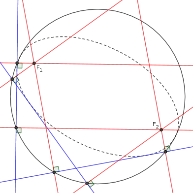

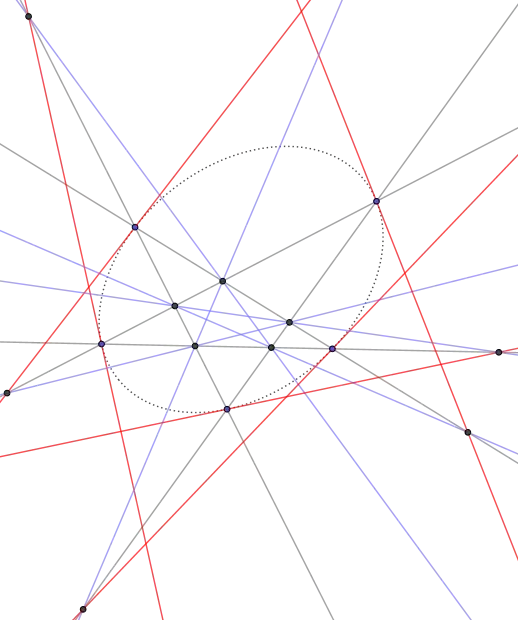

Finding the tangents

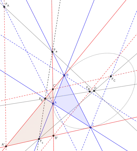

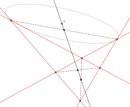

This is done using Pascal's theorem, pretending that one of the given five points is actually two infinitesimally close points on the conic, thus their joining line becomes a tangent to the conic. Constructing all five tangents this way can be illustrated with a nested-pentagram drawing as depicted below, with the resulting tangents colored red. This works for all types of conic sections. Bonus: This only needs a straightedge, unless points at infinity arise.
Five tangents from five points on a conic section
Just in case: The reverse can be done using a corresponding limit case of Brianchon's theorem, illustrated in the figure below.
Five points from five tangents to a conic section

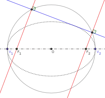

By intersecting diameters. Choose three of the given five points, say $A,B,C$, and construct a line $c$ through $C$ parallel to the line $\overline{AB}$. Then, using Pascal's theorem, construct the other point of intersection of $c$ with the conic, call it $C'$. Now we have parallel chords $[\overline{AB}]$ and $[\overline{CC'}]$. The line through their midpoints is known to pass through the center of the conic, therefore we call it a diameter. See the figure below. The solid black line is the diameter conjugate to the slope of the parallel blue lines. The construction shown is straightedge-only after having constructed the parallel line; it actually yields the polar of the point where the blue lines intersect. In this case, that point is at infinity, which implies that its polar passes through the center.
Diameter (black) conjugate to parallel lines (blue)
Repeat with different choices for $A,B,C$ such that $\overline{AB}$ changes slope; the intersection of the two diameters yields the conic's center.

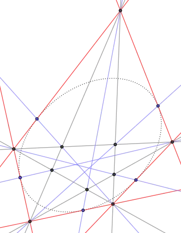

By intersecting Newton-Gauß lines. I prefer this one. Construct the five tangents first, then pick four of them. These form a complete quadrilateral. A complete quadrilateral has three diagonals, the midpoints of which are collinear. The containing line is known as Newton-Gauß line of the complete quadrilateral. It contains the centers of all conics with the given four tangents. This is illustrated below.
Center on Newton-Gauß line
So, construct that Newton-Gauß line, then make another choice of four tangents out of the five given, and construct their Newton-Gauß line. Intersecting the two Newton-Gauß lines yields the conic's center.

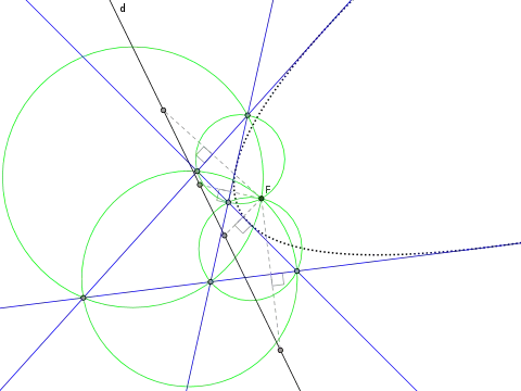

Finding symmetry axes and asymptotes, if any
Back to the general case. We already have the center, so we just need to find lines with the slopes of the desired axes or asymptotes, then parallel-shift those lines such that they pass through the center.
The main trick to find the interesting slopes from given five points is isogonal conjugation, also used in my answer to a related question. Pick three of the given five points, say $A,B,C$ and use these as reference triangle. Generally, the isogonal conjugate $P'$ of a point $P\not\in\lbrace A,B,C\rbrace$ is the point of concurrence of the lines $(\overline{AP})^{\angle CAB}$, $(\overline{BP})^{\angle ABC}$ and $(\overline{CP})^{\angle BCA}$. Here, $(\overline{AP})^{\angle CAB}$ means mirroring the line $\overline{AP}$ across the angle bisector of $\angle CAB$. The inverse transform is again isogonal conjugation.
Note that the conic is a circumconic of $ABC$. Construct the isogonal conjugates $D',E'$ of the remaining two points $D,E$. Now the line $\overline{D'E'}$ contains the isogonal conjugates of all points of the conic (if we define image points of $A,B,C$ by continuity along the conic). In a sense, we have morphed the conic into a line.
There are other operations beside isogonal conjugation that can morph a conic into a projective line, but isogonal conjugation has an additional useful feature, which is as follows.
Let $u$ denote the circumcircle of $ABC$. Isogonal conjugation turns points on $u$ into points at infinity (if we remove singularities at $A,B,C$ suitably) and vice versa. This leads to the following observations:
  • If both $D'$ and $E'$ are points at infinity, then $\overline{D'E'}$ is the line at infinity, and the conic is the circle $u$ itself. The following considerations assume that this is not the case.
  • If the line $\overline{D'E'}$ intersects $u$, then the points of intersection $P_1',P_2'$ are the isogonal conjugates of the points at infinity $P_1,P_2$ that belong to the conic. This implies that the conic is a hyperbola (or a parabola if $P_1=P_2$), and $P_1,P_2$ represent the slopes of its asymptotes (or the slope of the symmetry axis of the parabola).
    $P_1,P_2$ can be obtained as isogonal conjugates of $P_1',P_2'$. When breaking this down to more elementary steps, each $P_i$ will arise as intersection of parallel lines. Since we only need to know the associated slope, we are done as soon as we have constructed one of those lines. Concretely, if $P_i'\neq A$, we can mirror $\overline{AP_i'}$ across the angle bisector of $\angle CAB$; the resulting line has the sought slope.
  • If there are no points of intersection $P_i'$, then the conic is an ellipse.

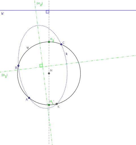

  • The slope of the line $\overline{D'E'}$ determines the slopes of the principal axes of the conic. To see why, consider the point at infinity of $\overline{D'E'}$. Let us name it $K'$. It must be the isogonal conjugate of a point $K$ both on the conic and on $u$, therefore $A,B,C,K$ are concyclic. The family of conics through $A,B,C,K$ is a pencil of conics; the associated quadratic forms are linear combinations of the quadratic forms of two of its member conics. One of the forms can be chosen to be the circle $u$. However, combining a quadratic form with a circle form does not change the slopes of the associated principal axes. Therefore, all conics through concyclic $A,B,C,K$ share a common pair of slopes for their principal axes. Isogonal conjugation turns the conics in that pencil into lines parallel to $\overline{D'E'}$ (formally, a pencil of lines through the point at infinity $K'$).
    We do not even need to construct $K$. Instead, consider the two lines $h_1',h_2'$ parallel to $\overline{D'E'}$ that just touch $u$, and name the points of tangency $H_1',H_2'$. Isogonal conjugation yields $H_1,H_2$ which are the points at infinity of the two parabolas through $A,B,C,K$. For those, $H_1,H_2$ represent slopes of principal axes, and those apply to all conics in the pencil, including our conic.
    Geometrically, $H_1', H_2'$ are the points of intersection of the line $r$ with $u$, where $r$ is the line orthogonal to $\overline{D'E'}$ that passes through the center of $u$.
    Sanity check: $H_1',H_2'$ are antipodes on $u$. By Thales's theorem, $\overline{AH_1'}$ and $\overline{AH_2'}$ are orthogonal, as are $(\overline{AH_1'})^{\angle CAB}$ and $(\overline{AH_2'})^{\angle CAB}$. Therefore the slopes represented by $H_1,H_2$ turn out to be orthogonal, as they should be.
Pointwise isogonal conjugation
Sidenote: With isogonal conjugation, it is easy to prove that a circumconic of a non-right-angled triangle is a rectangular hyperbola if and only if the circumconic also passes through the triangle's orthocenter.

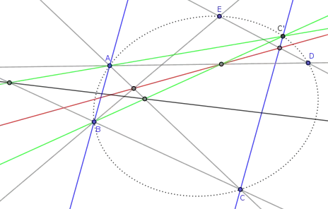

To find the vertices on $\overline{OH}$ (if any), pick one of the given points on the conic, say $A$, and its associated tangent $t_A$. Mirroring $A$ across $\overline{OH}$ yields another point $A'$ on the conic. Imagine mirroring the tangent $t_A$ to $t_{A'}$ as well. Set $\lbrace P\rbrace = t_A\cap t_{A'} = t_A\cap\overline{OH}$ and $\lbrace Q\rbrace = \overline{AA'}\cap\overline{OH}$. Now $p=\overline{AA'}$ is the polar associated with the point $P$, which implies that $P,Q$ and the two vertices $V_{1,2}$ on $\overline{OH}$ form a harmonic range. Those vertices exist (as real points) if and only if the center $O$ is outside the segment $[\overline{PQ}]$, otherwise we have a hyperbola and $\overline{OH}$ contains the minor axis and no (real) vertices.
Assuming that $O$ is outside the segment $[\overline{PQ}]$, the harmonic-range property implies that
$$\left\vert OP\right\vert\cdot\left\vert OQ\right\vert = \left\vert OV_{1,2}\right\vert^2$$
Therefore we can find $V_{1,2}$ with a geometric-mean construction. Here is one of those: Construct a Thales circle $s$ on $[\overline{PQ}]$, call its center $S$. Construct a Thales circle on $[\overline{OS}]$, intersecting $s$ in the points $S_{1,2}$. Draw a circle around $O$ through $S_{1,2}$; this one intersects $\overline{OP}$ in $V_{1,2}$.
Note that this construction works not only along a symmetry axis; actually it works for any pole-polar pair $(P,p)$ with $\lbrace Q\rbrace = p\cap\overline{OP}$, as long as $O\not\in[\overline{PQ}]$. It yields the points of intersection of $\overline{OP}$ with the conic, provided that $O$ is their midpoint. This is illustrated below.
Points on a conic from given pole-polar pair and center

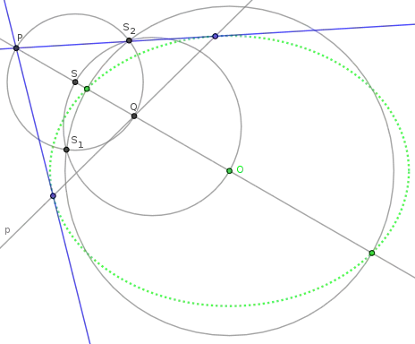

Finding the foci
From major vertices and one tangent: Herein, vertices are considered to be major (resp. minor) if the conic has maximal (resp. minimal) curvature there. An ellipse also has minor vertices, but the method presented here does not need those and works for hyperbolas as well.
Draw the major vertex circle around the conic's center $O$, passing through the major vertices. Now pick any tangent that does not pass through a major vertex. That tangent has to intersect the major vertex circle in two points $P_1,P_2$. Draw perpendiculars $p_1,p_2$ to the tangent through those points. Then $p_1,p_2$ intersect the major axis in the foci.
Getting the perpendiculars does not need a compass because we can simply draw the lines $\overline{OP_{1,2}}$, and their four points of intersection with the major vertex circle (including $P_{1,2}$) form a rectangle.
Foci from major axis and tangent
This method essentially tells us that the pedal point of a focus on a tangent always lies on the major vertex circle. Imagine the pedal point and the major vertex circle scaled away from the focus with a factor of 2, and you get the perhaps more familiar statement that mirroring a focus across a tangent yields a point whose distance to the other focus equals the distance between the major vertices.
From three tangents and the major vertex circle: We could generalize the previous approach to only need the major vertex circle, but not the major axis, as long as we also have three pairwise nonparallel tangents available.
The major vertex circle has to intersect the given three tangents in $3\times2$ points (counted with multiplicity). Draw perpendiculars to the intersected tangents there. There will be two points $F_1,F_2$, symmetric around $O$, where three of these perpendiculars meet. Those are the foci. This is illustrated below.
Foci from three tangents and major vertex circle
As before, if you have the circle and its center $O$ drawn already, the perpendiculars can be constructed with straightedge only.
One practical problem with this method is that it requires exactness. If you get the major vertex circle radius wrong by a tiny amount, then there will be no three concurrent perpendiculars.
The other obvious drawback is that you need the major vertex circle. Determining that with the methods outlined above requires finding vertices, which requires finding symmetry axes in turn. Therefore this approach does not actually save work.

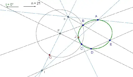

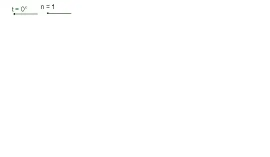

  • @David: I found a source on wikipedia that solves the problem, here : https://en.m.wikipedia.org/wiki/Rytz%27s_construction – Orest Bucicovschi Dec 29 '16 at 12:06
Point $G$ is a dynamic point on circle containing $C$.
Point $J$ forms a locus of the conic containing $A$, $B$, $C$, $D$ and $E$.
Ng Chung Tak
  • 19,693
  • Thanks @Ng. This is a method I haven't seen for generating an ellipse without knowing the foci or axes, but it still doesn't quite answer my original question. I'm trying to graphically locate either the foci or the axes because if I can locate any of these key elements, I can easily derive the others. If I can't get an answer to that question, your method may be useful to me anyway as an alternative approach to the problem that has prompted my question, so thanks for providing the detailed drawings too. – David Dec 27 '16 at 06:43
