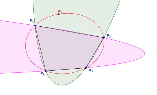

One can always construct two parabolas passing through $p_1$, $p_2$, $p_3$, $p_4$ (green and pink in the figure below), each one possibly degenerating into a couple of parallel lines if two opposite sides of quadrilateral $p_1p_2p_3p_4$ are parallel. Point $p_5$ will determine an ellipse if it lies inside either parabola but not in their intersection.
This follows from the fact that five points always determine a conic section, and because the parabola is a limiting case between ellipse and hyperbola: each time $p_5$ crosses the boundary of a parabola, conic section $p_1p_2p_3p_4p_5$ switches from ellipse to hyperbola (or viceversa).
  • it looks nice! but how one can prove it? – Kelly May 13 '19 at 19:19
  • @Kelly For the relation between the position of $P$ and the kind of conic, the argument I gave is itself a proof (just consider the sign of $B^2-4AC$ as a function of $p_5$). Proving that two parabolas pass through the four vertices of a convex quadrilateral is harder: at the moment I don't have a satisfying construction. – Intelligenti pauca May 13 '19 at 19:30
  • And what to do if the 4 points are a square? – Kelly May 13 '19 at 20:03
  • Parabolas then become two couples of parallel lines, but the result still holds. – Intelligenti pauca May 13 '19 at 20:05
    See here for a proof that four points determine two parabolas: http://www2.washjeff.edu/users/mwoltermann/Dorrie/45.pdf – Intelligenti pauca May 13 '19 at 20:07
  • Thank you very much! – Kelly May 13 '19 at 20:15
    Here's another proof: https://www.mathpages.com/home/kmath546/kmath546.htm They also prove that the quadrilateral must be convex. – Intelligenti pauca May 13 '19 at 20:17
  • very interesting (+1). I got curious to know how the axes of the two parabolas are related to the four points: do you have any idea for that ? – G Cab Oct 10 '20 at 22:50
  • @GCab I don't know if some "nice" relation exists, you can find some formulas at the second site referred above: https://www.mathpages.com/home/kmath546/kmath546.htm – Intelligenti pauca Oct 11 '20 at 16:42

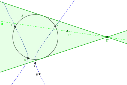

The solution to your problem is therefore to construct the isogonal conjugate $D'$ of $D$ and its tangents to the circumcircle $U$ of $ABC$. Then, when given another point $E$ of the conic, construct its isogonal conjugate $E'$ and test whether $\overline{D'E'}$ intersects $U$. The region for $E'$ where such intersection happens is bounded by the tangents to $U$ through $D'$ and is tinted green in the figure below.
Classification of a conic using isogonal conjugation "Classification of a conic using isogonal conjugation"
  • If $E'$ is inside the green region, the conic is a hyperbola, possibly degenerated to a pair of nonparallel lines (if $\overline{D'E'}$ intersects a vertex of $ABC$).
  • If $E'$ lies on a bounding tangent, the conic is a parabola, possibly degenerated to a pair of parallel lines (if the point of tangency is a vertex of $ABC$).
  • Otherwise the conic is an ellipse.
For those bounding tangents to exist, $D'$ must not be inside $U$. Isogonal conjugation translates this requirement to $A,B,C,D$ being vertices of a convex 4-gon, as given in the problem statement.
