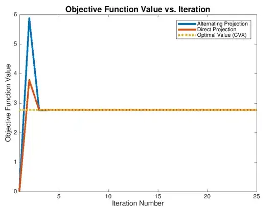

Result of a run:
As expected, the Direct Projection is faster to converge.
Also, the direct projection at each iteration generates a solution which obeys the constraint while the Alternating Projection isn't guaranteed (Though violation is really small).

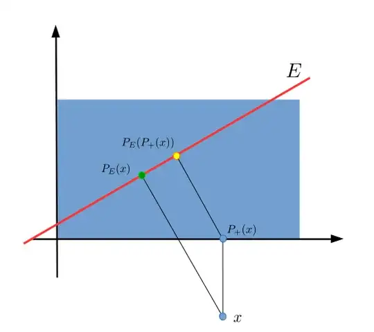

Unfortunately what you're trying to do is not correct as you can see in the following figure:
Composition of projections
You are taking the projection of the gradient step on $\{x: x\geq 0\}$ and then you are taking a second projection on $E=\{x:\sum_i x_i = 1\}$, that is, you end up with $P_E(P_+(x))$ which is different from $P_{E\cup +}(x)$. I am not sure whether what you are using will converge to an optimal point.
Judging from the above figure, it might be best to first project on $E$ and then on the positive quartile (that is $P_{E\cup +}(\cdot) = P_E(P_+(\cdot))$, but sketches are other deceptive, so you need to prove it. For sure, what you are currently using does not correspond to the projected gradient method.
