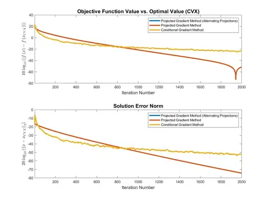

So I wrote a MATLAB Code which is accessible in my StackExchange Mathematics Q2935650 GitHub Repository.
The solvers I implemented / used are as following:
  1. CVX as a reference.
  2. Projected Gradient Descent with Projection onto the Unit Simplex as I implemented in Orthogonal Projection onto the Unit Simplex.
  3. Projected Gradient Descent with Projection onto the Unit Simplex implemented as Alternating Projections for the projection of the intersection of 2 convex sets. See Projections onto Convex Sets and How to Project onto the Unit Simplex as Intersection of Two Sets (Optimizing a Convex Function).
  4. Conditional Gradient Method (Frank Wolfe Algorithm).
The results are given by:
Timing for handling your case of $ A \in \mathbb{R}^{1500 \times 500} $ is less than a second in either of the methods I implemented.
The Frank Wolfe method is simple for this case. Indeed the Set is compact hence convergence is guaranteed. Since the convex hull of the Unit Simplex is given by Standard Basis the optimization is simple:
$$ \arg \min_{s \in \Delta} \nabla f \left( x \right)^{T} s = \arg \min_{i} {\left( \nabla f \left( x \right) \right)}_{i} $$
Where $ f \left( x \right) = \frac{1}{2} {\left\| A x - b \right\|}_{2}^{2} $ and $ \Delta = \left\{ x \mid \boldsymbol{1}^{T} x = 1, \, x \succeq 0 \right\} $ is the Unit Simplex Set.
So the solution is basically the element of the gradient with the minimal value.
This method becomes really simple and very fast for your case.
