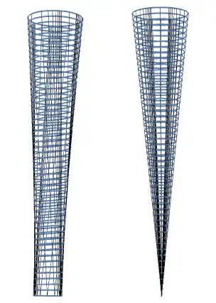

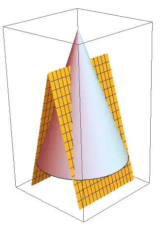

Two cutting planes shown symmetric to cone axis meeting below its vertex before removing Region above the planes. What remains is like the Calippo shape of different geometric proportion.
EDIT1:
If $ 2r,2w, h $ ,concurrency of straight cone generators are indicated as being given, then the truncated shape is uniquely given as part of cone of semi vertical angle= $ \tan^{-1}\dfrac{r-w}{h}.$
Calippo

  • Not really. That's similar to the "round chisel" found by @Seyed and that's not it. – SQB Oct 24 '16 at 07:07
  • Above is a cone different from @Seyed's cylinder, Both have elliptic intersections, For large height/radius ratio it is difficult to tell the difference. – Narasimham Oct 24 '16 at 07:19
