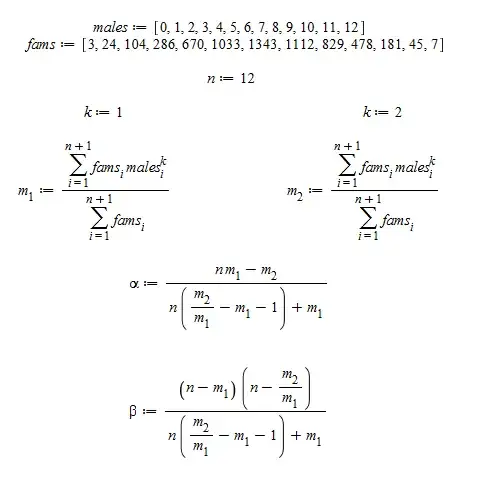

  • That's much closer to what he got, but it's still off by a little bit: http://i.minus.com/iblbDxkM2OlM9j.png (using maple you can see the values are ~6.22 and ~40.39 – ParoX Aug 22 '12 at 11:07
  • In both formulas, you define the scalar product of vectors of size 13 as if their size was 12. No wonder your result is off. And your formulas $\sum_i(x_iy_i)^k/\sum_iy_i^k$ should read $\sum_ix_i^ ky_i/\sum_iy_i$. – Did Aug 22 '12 at 11:24

Just for historical purposes, here is how I got the $\alpha$ and $\beta$ using Maple 15:
Maple code:
males := [0, 1, 2, 3, 4, 5, 6, 7, 8, 9, 10, 11, 12];
fams := [3, 24, 104, 286, 670, 1033, 1343, 1112, 829, 478, 181, 45, 7];
n := 12;
k := 1;
m[1] := (sum(fams[i]*males[i]^k, i = 1 .. n+1))/(sum(fams[i], i = 1 .. n+1));
k := 2;
m[2] := (sum(fams[i]*males[i]^k, i = 1 .. n+1))/(sum(fams[i], i = 1 .. n+1));
alpha := (n*m[1]-m[2])/(n*(m[2]/m[1]-m[1]-1)+m[1]);
beta := (n-m[1])*(n-m[2]/m[1])/(n*(m[2]/m[1]-m[1]-1)+m[1]);
printf("
n = %d
m_1 = %f
m_2 = %f
alpha = %f
beta = %f
", n, m[1], m[2], alpha, beta)
Output:
n = 12
m_1 = 6.230581
m_2 = 42.309403
alpha = 34.135021
beta = 31.608492
