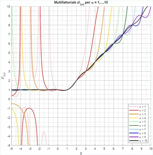

Some years ago I calculated the equation of the multifactorial:
$$z!_{(\alpha)}=\alpha^{\frac{z}{\alpha}}\Gamma\left(1+\frac{z}{\alpha}\right)\prod_{j=1}^{\alpha-1}\left(\frac{\alpha^{\frac{\alpha-j}{\alpha}}}{\Gamma\left(\frac{j}{\alpha}\right)}\right)^{C_{\alpha}(z-j)}$$ Where
$$C_{\alpha}(x)=\frac{1}{\alpha}\sum_{k=1}^{\alpha}\cos\left(\theta_{k}\ x\right)\qquad\text{ where }\theta_{k}=\operatorname{cos^{-1}}\left(\cos\left(\frac{2k\pi}{\alpha}\right)\right)$$
Graph
This function respects these relationship:
