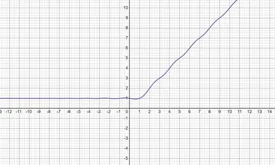

At the end of everything, a function with the following characteristics must emerge:
  • $n!_{(\infty)}=n$ for $n\in\mathbb{N}^{+}$
  • $n!_{(\infty)}=1$ for $n=-1,-2,-3,...$
  • $\displaystyle\prod_{i=0}^{\infty}(z-i)!_{(\infty)}=z!$
This is the graph:
I'll also leave this link which leads to the desmos graph I made in case anyone wants to try their hand at trying to solve it.
