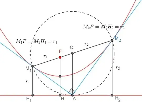

Here is a simple alternative way, fully geometrical.
Have a look at the following picture, with $M_1,M_2$ on parabola with focus $F$ and directrix $D$, $H_1, H_2, H$ the orthogonal projections on $D$ of $P_1, P_2, F$ resp.
Let $r_k:=M_kH_k=M_kF \ (k=1,2)$. Let $C$ be the midpoint of $M_1M_2$, i.e., the center of the circle with diameter $M_1M_2$. The radius of this circle is $r=\dfrac{r_1+r_2}{2}$.
In trapezoid $M_1,H_1,H_2,M_2$, consider line segment $[FH]$ joining midpoints $C$ and $H$ of line segments $M_1M_2$ and $H_1H_2$ resp. The length of $[FH]$ is the mean $\dfrac{r_1+r_2}{2}$ of the lengths $r_1$ and $r_2$ of $[M_1H_1]$ and $[M_2H_2]$ resp., i.e., the radius of the circle, as desired.
Please note the right angle in $A$ ; it refers to a classical property of focal chords such as $M_1M_2$ : the tangents to the intersections of the focal chord with the parabola 1) are orthogonal and 2) have their intersection point on the directrix.
