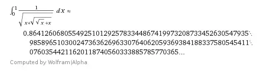

This result corresponds with the numeric calculations
Numeric calculations of the issue integral
and confirms the obtained formulas for the antiderivative.
