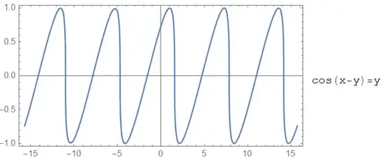

Plotting the function $y(x)$ implicitly we get a smooth sawtooth-like wave:
y=cos(x-y)

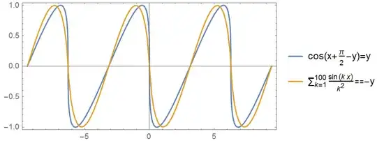

I wanted to illustrate the very helpful answers and comments I've been given so far.
First, credit goes to Lucian for introducing me to Clausen function (see the first comment below). However, this function does not have vertical tangents anywhere, as you can see in the graph (I plotted Clausen using its Fourier series, since it's easier than the integral definition):
Clausen function
So, the function I defined here is much more "sawtooth-like".

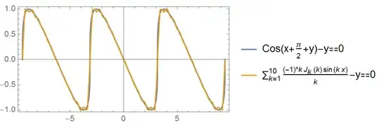

And finally, davik gave the parametric form for the function and figured out its Fourier series, which I plot below:
You may notice I displaced and reversed the original function when plotting these graphs. We can also use sine instead of cosine if needed.

Note that this function's graph can be parametrized as $ x(t) = t + \cos(t)$ and $ y(t) = \cos (t)$
So, we can pretty much use this to find most interesting things you may want to know. First, it is a shear of the graph of $ y = \cos(x)$ by the matrix $$ \pmatrix{1 & 1 \\ 1 & 0} $$ Which tell you the zeros and maxima. Also, if you want vertical tangents, since $y'(t) = - \sin(t);~~ x'(t) = 1 - \sin (t)$ you have vertical tangents at $\frac{\pi}{2} + 2\pi k$.
If we shift this to the right by $\frac{\pi}{2}$, then by quite straightforward computation, together with the definition of the Bessel function, we get that the nth fourier sine series coefficent
$$b_n = \frac{2(-1)^nJ_n(n)}{n}$$ where $J_n(x)$ is the Bessel function of the first kind.
