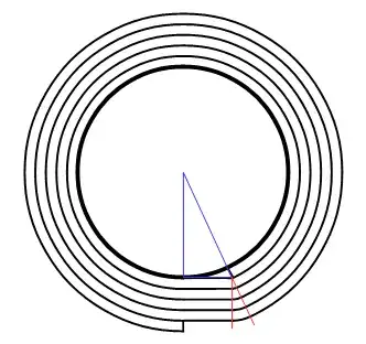

The assumption that the layers are all cylindrical is a good first approximation.
The assumption that the layers form a logarithmic spiral is not a good assumption at all, because it supposes that the thickness of the paper at any point is proportional to its distance from the center. This seems to me to be quite absurd.
An alternative assumption is that the layers form an Archimedean spiral. This is slightly more realistic, since it says the paper has a uniform thickness from beginning to end. But this assumption is not a much more realistic than the assumption that all layers are cylindrical; in fact, in some ways it is less realistic.
Here's how a sheet of thickness $h$ actually wraps around a cylinder. First, we glue one side of the sheet (near the end of the sheet) to the surface of the cylinder. Then we start rotating the cylinder. As the cylinder rotates, it pulls the outstretched sheet around itself. Near the end of the first full rotation of the cylinder, the wrapping looks like this:
Notice that the sheet lies directly on the surface of the cylinder, that is, this part of the wrapped sheet is cylindrical.
At some angle of rotation, the glued end of the sheet hits the part of the sheet that is being wrapped. The point where the sheet is tangent to the cylinder at that time is the last point of contact with the cylinder; the sheet goes straight from that point to the point of contact with the glued end, and then proceeds to wrap in a cylindrical shape around the first layer of the wrapped sheet, like this:
As we continue rotating the cylinder, it takes up more and more layers of the sheet, each layer consisting of a cylindrical section going most of the way around the roll, followed by a flat section that joins this layer to the next layer. We end up with something like this:
Notice that I cut the sheet just at the point where it was about to enter another straight section. I claim (without proof) that this produces a local maximum in the ratio of the length of the wrapped sheet of paper to the greatest thickness of paper around the inner cylinder. The next local maximum (I claim) will occur at the corresponding point of the next wrap of the sheet.
The question now is what the thickness of each layer is. The inner surface of the cylindrical portion of each layer of the wrapped sheet has less area than the outer surface, but the portion of the original (unwrapped) sheet that was wound onto the roll to make this layer had equal area on both sides. So either the inner surface was somehow compressed, or the outer surface was stretched, or both.
I think the most realistic assumption is that both compression and stretching occurred. In reality, I would guess that the inner surface is compressed more than the outer surface is stretched, but I do not know what the most likely ratio of compression to stretching would be. It is simpler to assume that the two effects are equal. The length of the sheet used to make any part of one layer of the roll is therefore equal to the length of the surface midway between the inner and outer surfaces of that layer. For example, to wrap the first layer halfway around the central cylinder of radius $r$, we use a length $\pi\left(r + \frac h2\right)$ of the sheet of paper.
The reason this particularly simplifies our calculations is that the length of paper used in any part of the roll is simply the area of the cross-section of that part of the roll divided by the thickness of the paper.
The entire roll has inner radius $r$ and outer radius $R = r + nh$, where $n$ is the maximum number of layers at any point around the central cylinder. (In the figure, $n = 5$.) The blue lines are sides of a right triangle whose vertices are the center of the inner cylinder and the points where the first layer last touches the inner cylinder and first touches its own end. This triangle has hypotenuse $r + h$ and one leg is $r$, so the other leg (which is the length of the straight portion of the sheet) is $$ \sqrt{(r + h)^2 - r^2} = \sqrt{(2r + h)h}.$$ Each straight portion of each layer is connected to the next layer of paper by wrapping around either the point of contact with the glued end of the sheet (the first time) or around the shape made by wrapping the previous layer around this part of the layer below; this forms a segment of a cylinder between the red lines with center at the point of contact with the glued end. The angle between the red lines is the same as the angle of the blue triangle at the center of the cylinder, namely $$ \alpha = \arccos \frac{r}{r+h}.$$
Now let's add up all parts of the roll. We have an almost-complete hollow cylinder with inner radius $r$ and outer radius $R$, missing only a segment of angle $\alpha$. The cross-sectional area of this is $$ A_1 = \left(\pi - \frac{\alpha}{2} \right) (R^2 - r^2).$$ We have a rectangular prism whose cross-sectional area is the product of two of its sides, $$ A_2 = (R - r - h) \sqrt{(2r + h)h}.$$ Finally, we have a segment of a cylinder of radius $R - r - h$ (between the red lines) whose cross-sectional area is $$ A_3 = \frac{\alpha}{2} (R - r - h)^2.$$ Adding this up and dividing by $h$, the total length of the sheet comes to \begin{align} L &= \frac1h (A_1+A_2+A_3)\\ &= \frac1h \left(\pi - \frac{\alpha}{2} \right) (R^2 - r^2) + \frac1h (R - r - h) \sqrt{(2r + h)h} + \frac{\alpha}{2h} (R - r - h)^2. \end{align}
For $n$ layers on a roll, using the formula $R = r + nh$, we have $R - r = nh$, $R + r = 2r + nh$, $R^2 - r^2 = (R+r)(R-r) = (2r + nh)nh$, and $R - r - h = (n - 1)h$. The length then is \begin{align} L &= \left(\pi - \frac{\alpha}{2} \right) (2r + nh)n + (n - 1) \sqrt{(2r + h)h} + \frac{\alpha h}{2} (n - 1)^2\\ &= 2n\pi r + n^2\pi h + (n-1) \sqrt{(2r + h)h} - \left( n(r + h) - \frac h2 \right) \arccos \frac{r}{r+h}\\ &= n (R + r) \pi + (n-1) \sqrt{(2r + h)h} - \left( n(r + h) - \frac h2 \right) \arccos \frac{r}{r+h}. \end{align}
One notable difference between this estimate and some others (including the original) is that I assume there can be at most $(R-r)/h$ layers of paper over any part of the central cylinder, not $1 + (R-r)/h$ layers. The total length is the number of layers times $2\pi$ times the average radius, $(R + r)/2$, adjusted by the amount that is missing in the section of the roll that is only $n - 1$ sheets thick.
Things are not too much worse if we assume a different but uniform ratio of inner-compression to outer-stretching, provided that we keep the same paper thickness regardless of curvature; we just have to make an adjustment to the inner and outer radii of any cylindrical segment of the roll, which I think I'll leave as "an exercise for the reader." But this involves a change in volume of the sheet of paper. If we also keep the volume constant, we find that the sheet gets thicker or thinner depending on the ratio of stretch to compression and the curvature of the sheet. With constant volume, the length of paper in the main part of the roll (everywhere where we get the the full number of layers) is the same as in the estimate above, but the total length of the parts of the sheet that connect one layer to the next might change slightly.
