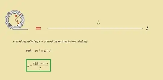

Find the area of rolled tape and that would be equal to the area of wounded up tape. enter image description here
Seyed
  • 9,041
  • that is not what I am asking – Desmoz Feb 15 '17 at 17:21
  • @ConnorGaughan, But didn't you ask this: ...Is there any way to calculate the exact length of tape given these parameters? – Seyed Feb 15 '17 at 17:23
  • I probably shouldn't have said "using these parameters" as the parameters don't make sense when we have a spiral instead of concentric circles, my bad (inner and outer diameters don't exist right?) – Desmoz Feb 15 '17 at 17:31
    @ConnorGaughan, Since the thickness of an usual tape is very thin then this method is quite accurate, but when it comes to a noticeable thick material then we need a different way of calculation. – Seyed Feb 15 '17 at 17:37
