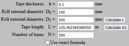

But on the "Roll length calculator" you found, the "approximate" length is $$ L_2 = \pi (D_0 + (N - 1)h) N, $$ using $L_2$ for this estimated length to distinguish it from the estimated length $L_1$ that the other formula computes.
That is, according to that page, an approximation of the length is $$ L_2 = L_1 - \pi h N = L_1 - \frac\pi2(D_1 - D_0). $$ What accounts for this difference?

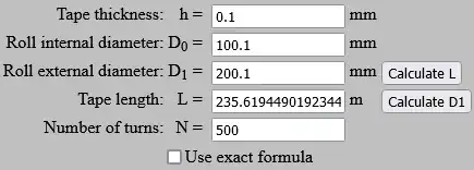

You can force the "Roll length calculator" to compute $L_1$ instead of $L_2$ by adding $h$ to both the inner and outer diameters before computing the length of the roll. For example, suppose the roll has inner diameter $100\text{ mm}$, outer diameter $200\text{ mm}$, and thickness $0.1\text{ mm}$. Then the $L_2$ result from the calculator is as follows:
You can get the corresponding $L_1$ result as shown below by adding $0.1$ to each diameter.
Note that the difference between these two results is $0.157079632679\text{ m}$, which is $157.079632679\text{ mm}$, which (in millimeters, to within the precision of the output of the calculator) is $\pi hN = \pi \times 0.1 \times 500$.

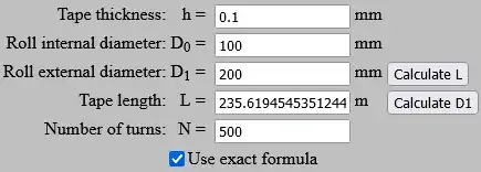

Now let's look at the "exact" result from the "Roll length calculator". For this calculation, it is assumed that the material is rolled into a portion of an Archimedean spiral. Let's call the resulting length $L_3$. The result for our example is shown below.
Evidently $L_3$ is larger than $L_2$, but it's not very different from $L_1$. In fact, in this example, the "exact" $L_3$ calculation gives a result that is only $0.005515890\text{ mm}$ greater than the $L_1$ result. That difference is less than $1/28000$ of the difference between $L_3$ and $L_2$.
