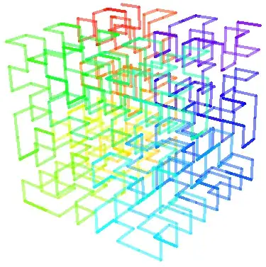

Space-filling curves, in particular the Hilbert curve (in 3D): alt text

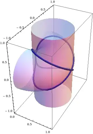

How about Viviani's curve? It is the intersection of a sphere with a cylinder. Viviani was a student (or disciple) of Gallileo. Wikipedia has a beautiful image:

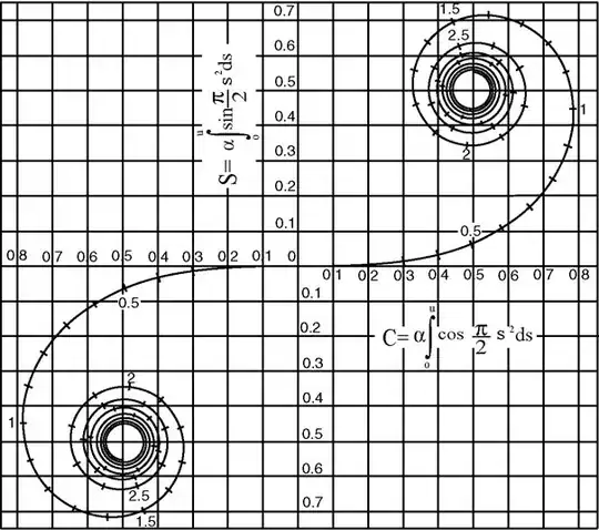

Though is it is not 3D, the Clothoid or Cornu Spiral is an amazing curve. It surely can be made 3D by adding a simple extra parameter $z(t)=t$. It has infinite length but converges to two points in the plane. It has several applications in optics and road engineering, for example. An it looks quite nice:

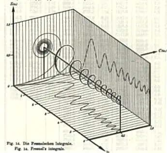

I found a 3D plot too: enter image description here
