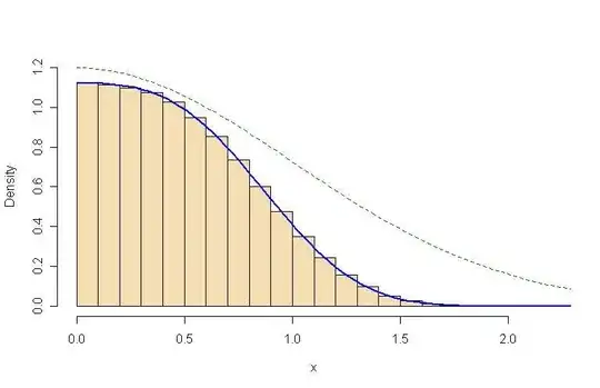

The program below, generates trial values from half normal, and accepts appropriate ones to give an independent random sample from $X$. We use the random sample to verify $E(X)$ and also to find $P(0.5 < X < 1.5),$ which cannot be found by ordinary analytical methods. (A histogram, shown below, illustrates that the sampled values closely approximate the target distribution.)

Histogram of about 667,000 accepted observations from $f(h)$, with graph of $f(h)$ (solid curve) and "envelope" $Mg(h)$ (dotted).
Notes: (1) About 2/3 of the trial points were accepted. A more tightly bounding envelope, if available, would give a higher acceptance rate. (2) The Metropolis-Hastings algorithm is a more complicated acceptance-rejection method used mainly for sampling from multivariate distributions. The simple univariate method illustrated here is similar in spirit to M-H, but (unlike M-H) it returns independent observations. (3) This method also illustrates importance sampling; the trial values are relatively concentrated in the region of the support where X's are most likely to occur.
