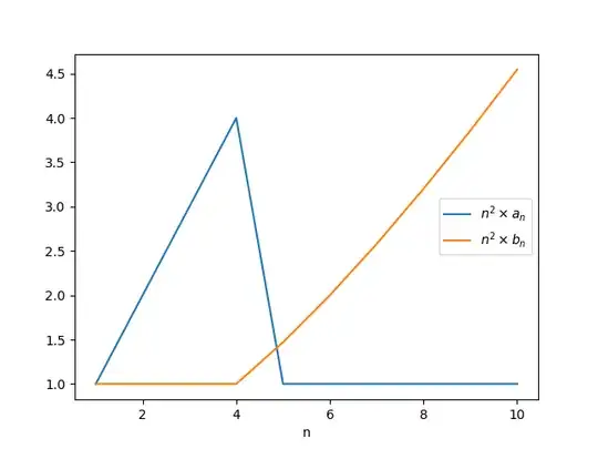

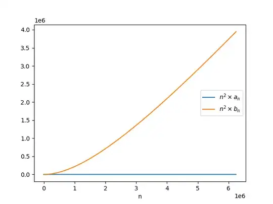

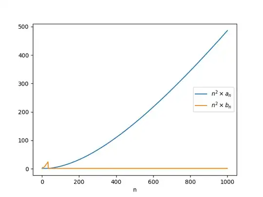

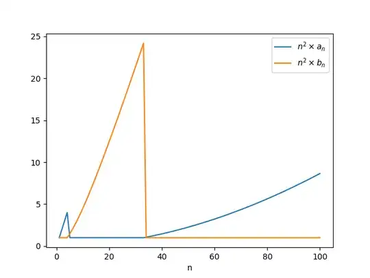

We can use this to inspect the behavior of the two sequences. For example, by graphing $n^2 a_n$ and $n^2 b_n$ against $n$, we see the alternating behavior predicted by Alex B. . Both sequences "take turns being the bottom", and the intervals at which one sequence dives below the other one get longer and longer.
Plot of nna_n and nnb_n from n=1 to 10 Plot of nna_n and nnb_n from n=1 to 100 Plot of nna_n and nnb_n from n=1 to 1000 Plot of nna_n and nnb_n from n=1 to 6244143
The first few values of $N_k$ corresponding to this program are $N_1=1$, $N_2=4$, $N_3=33$, $N_4=1906$, $N_5=6244143$.
