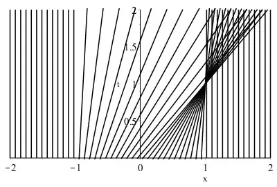

This problem is closely related to this one. The solution $u = g(x-ut)$ deduced from the method of characteristics is valid as long as it is single-valued, and we have $$ u(x,t) = \left\lbrace \begin{aligned} &0 &&\text{for}\; x < -1\\ &\tfrac{x+1}{t+1} &&\text{for}\; {-1}\leqslant x \leqslant t\\ &\tfrac{x-1}{t-1} &&\text{for}\; t\leqslant x \leqslant 1\\ &0 &&\text{for}\; x > 1 \end{aligned} \right. $$ Here, the solution is single-valued for times $t<t_b$, where $$ t_b = \frac{-1}{\inf g'} = 1 $$ is the breaking time. This time corresponds to the intersection of characteristic curves in the $x$-$t$ plane:
characteristics

  • Dear Sir Can you please tell me how domain of function u changes to -1<x<t How to show depedency on t.Please Help me – Curious student Sep 10 '19 at 15:37
    @MathLover From $u=g(x-ut)$ we deduce $u=1+(x-ut)$, i.e. $u=\frac{x+1}{t+1}$, as long as ${-1}\leq x-ut\leq 0$. Using the expression of $u$, the domain becomes ${-1}\leq \frac{x-t}{t+1}\leq 0$, i.e. ${-1}\leq x\leq t$. – EditPiAf Sep 10 '19 at 20:41
